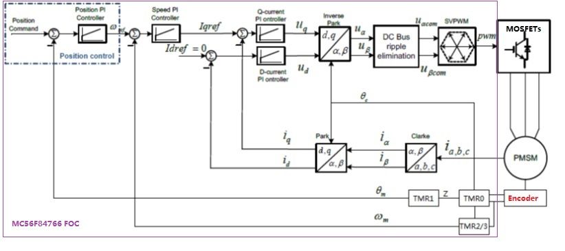

On my last project,  I used MC56F84766VLK as controller, and one quad encoder as angle/speed sample to realize PMSM motor control by using FOC algorithm:
where:
        (1)TMR0:quad timer0, input A/B signals from encoder as quad counter
            by one function:MCSTRUC_AngleFromEncoder() to output two angle signals as Park's & Inverse Park's angle signal(θe):
            gsM1_Drive.sSpeedPos.sAnglePosEl, gsM1_Drive.sSpeedPos.sAnglePosElUpdate
       (2) TMR1: quad timer1, input TMR0 OFLAG
            by one function:MCSTRUC_PosCalc() to get the relative position,θm: gsM1_Drive.sPosCalc.f32PosRelative
       (3) TMR2: quad timer2 and timer3, normal M/T speed calucation and low speed calucation
            by one function:MCSTRUC_SpeedClacMTMethod() to out normal speed signal,ωm:gsM1_Drive.sSpeedPos.f32Speed
            by one function:MCSTRUC_SpeedClacImproved() to out the startup speed signal:gsM1_Drive.sSpeedPos.f32SpeedImproved

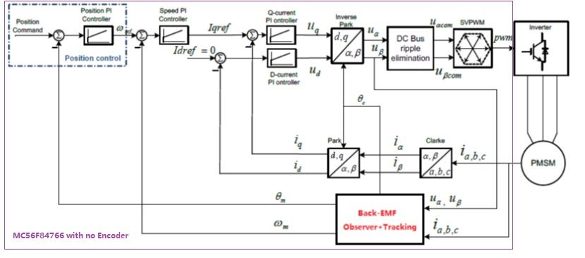

In order to get lower cost, we want to cancel the quad encoder,and consider to use back-emf observer+tracking algorithm to realize the sensorless FOC.
By browsing our NXP resource, we found one reference(AN5014SW) may realize our task. Functions CalcObs() and Update() can out angle signal(module->data.posElEst) and speed signal(module->data.velocityElEst).

(1) How to get these signals as like encoder? or, to replace them with the sensorless Observer+Tracking :
    (a)Angle signals:gsM1_Drive.sSpeedPos.sAnglePosEl, gsM1_Drive.sSpeedPos.sAnglePosElUpdate
   (b)Relative position signal:gsM1_Drive.sPosCalc.f32PosRelative
   (c)Speed signal:gsM1_Drive.sSpeedPos.f32Speed,gsM1_Drive.sSpeedPos.f32SpeedImproved

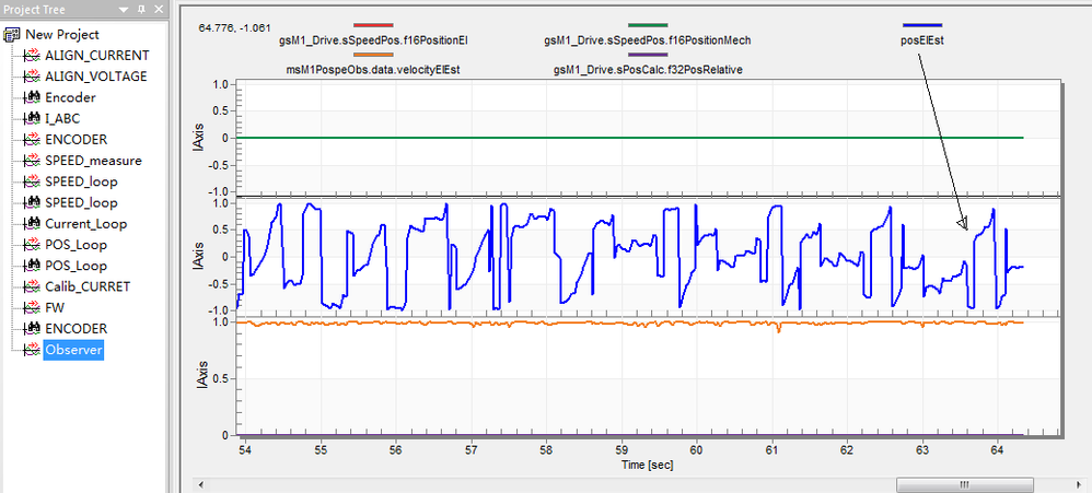

(2) Why the angle signal(module->data.posElEst) change too much when the motor stops?
as the below figure(captured by FreeMaster):

regarding encoder replacement by  Bemf observer + tracking observer for a position control is not very feasible. The observer requires for its functionality a minimum level of Back-emf voltages. These voltages are generated during PMSM rotation. Thus, the algorithm starts reliably working from 5%-10% of motor nominal speed. Under this speed the algorithm is not capable to estimate rotor speed and also rotor electrical position (integrated from estimated speed).
Typically the sensorless algorithm is used only for speed control while position control requires precise position feedback even for very low speed.

(2) We have studied AN5014SW, and find the estimation result of angle “posElEst” fluctuates very highly even on stop state and run state. We have captured the below signal as below:
