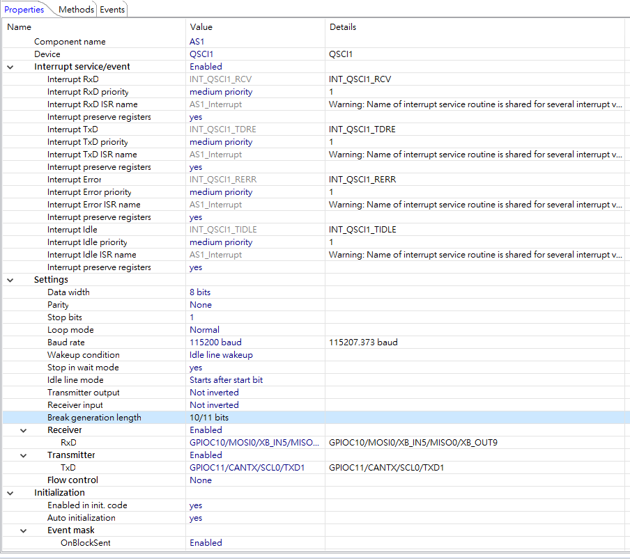

Below is my processor expert of Serial LDD setting.
And I follow the "Help Component" to porting my code as below

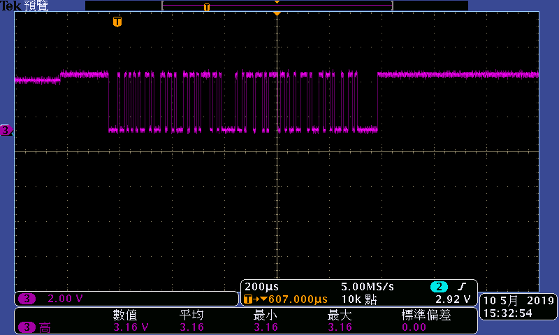

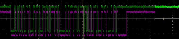

I can't receive any message from the terminal. When I check the waveform. It seem some problem in the last stop bit.
It extends the stop bit.

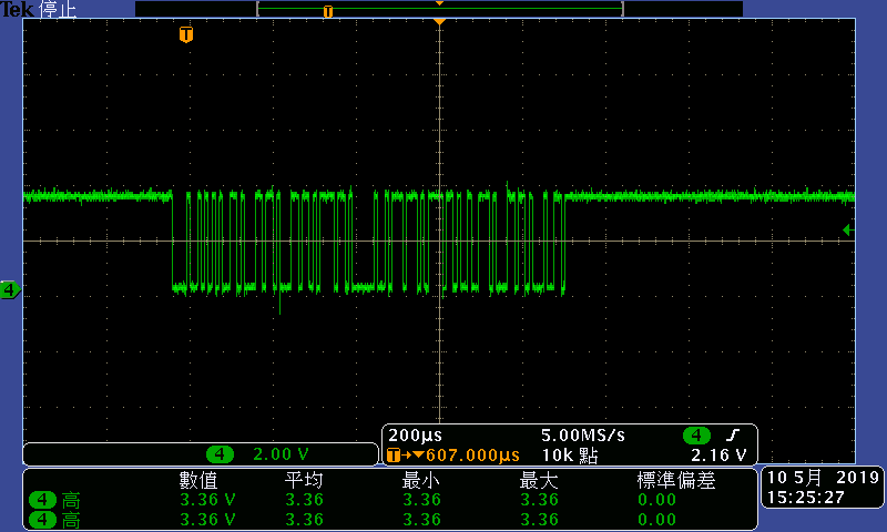

I user other kinetis MCU to sent same word. It looks whole different in the last stop bit.

It looks like the data is the same except for a small difference in timing and the long low time at the end.
In the image below you do get the Stop bit (high) but the long low time looks like a Brake.
Maybe try setting the "Break generation length" to some other value, 0?
Also check to see if the pin is set as Peripheral in the GPIO.
