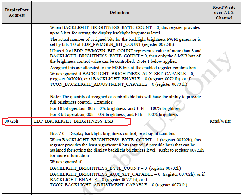

We would like to change the PWM value of PTN3460I from a Linux PC through Display Port. We expected the PTN3460I to be recognized by the PC as an I2C(I2C-over-AUX) device (slave address 0xC0) but could not find the slave address. Is it correct to access via AUX-CH(DPCD) instead of I2C? The EDID could be read at the slave address 0x50. Please tell us the correct access method.

PTN3460I default PWM setting is 12 bit, so that the DPCD register 0x722/0x723 working range is 0x000 – 0xFFF.
0x000 means PWM duty cycle = 100%, so PWM = 3.3V. And 0xFFF means PWM duty cycle  = 0%, so PWM = 0V.

Yes, you will have to to access via AUX-CH (DPCD register) instead of I2C if you want to change the PWM value of PTN3460I from a Linux PC through DisplayPort.
You will need to change DPCD register 0X722 and 0x723 via DP AUX channel to modify display brightness according to eDP (Embedded DisplayPort) specification v1.3 in below figures.

In case of PTN3460I, what are the maximum and minimum values ​​of brightness? We think 0x1000 is 0% and 0x0000 is 100%. Is it correct?
