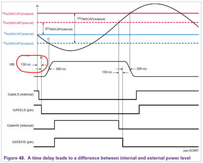

Hello, I notice that in Chapter 18, the minimum non-overlap time is 200ns, but after calculating the deadtime of LLC under 300kHz, the optimal deadtime is 73ns. In this case, I hope you will give a constructive help or advice, how could I optimize the parameter. Thanks!

it doesn't include 150ns.

The deadtime I get from external pin is 50ns or 200ns?

200ns.

You should follow this parameter specification of this IC.

If I need MOSFET working in the best frequency, I have to set the minimum non-overlap time parameter by using RDK01DB1561 development programming board?
Besides, I need to know whether the minimum non-overlap time 200ns contains the fixed HB intern delay time 150ns. I mean 150+50ns. Or 50ns contains HB intern delay time.
