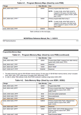

anyone can explain the fact that when I write data to the 56F83783 chip's flash address 20000, I see in  the debug window that my data is actually written to 30000. I have to read it from 30000 to get the written data. all written data has the same offset. please explain the logic and the correct writing process. Thanks.

This is the program memory map of 56F83xxx.
The same memory space are mapped to both Program space P: and data space X:
Furthermore, the 128KW memory are classified as bank 0 and bank 1.
for example the 64KW memory(bank0) is located at P:0x0000 to 0x FFFF, meanwhile, it is also mapped to X:2_0000 to 0x2_FFFF
another 64KW memory(bank1) is located at P:0x1_0000 to 0x1_ FFFF, meanwhile, it is also mapped to X:3_0000 to 0x3_FFFF
If it does not answer your question, I am sorry, pls clarify your question.

sorry rong, probably I did not explain myself and cause a confusion:
56F83783
I am writing and reading to the data memory, NOT program memory. when I write data to 2A000 I can see the written data in the debug window at address 35000. if I want to read it - I can read from 35000 and get the data. I am working with it, but do not understand the reason to this offset. (constant B000). it is very strange. both addresses are used by X databus, so writing data to an address should be read at the same address.
I am working with this offset for writing and reading data, and my application works good....

Hi rong
saw your example. you wrote to P:1FC00 and saw the data at X:3FC00. it is normal as in the manual it is written that x:20000-3ffff is mapped from p:0-1ffff.
in my case, I am writing data to x:2A000 and see it at x:35000. reading x:2A000 gives 0.
anyhow, I hope that this is my last project with this old family. I am checking the A153. hope it will be good for industrial / motor applications.
