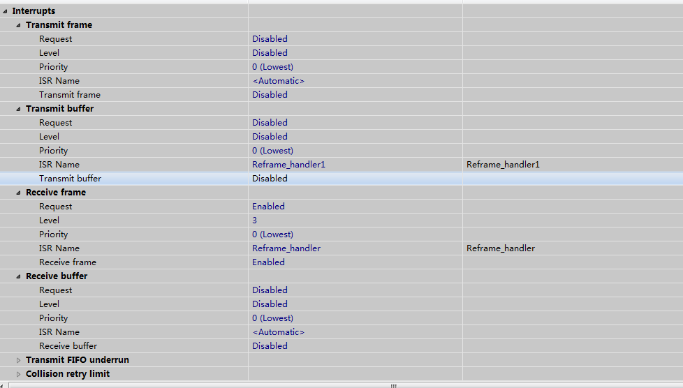

Use Freescale codefire52233 chip, use of official Ethernet test source, the Ethernet module can send and receive data, but use of PE configuration of the module, still use the official source code, the program does not send and receive data, how to solve

The following additional test source code。

What the Ethernet test code you used? Does the MQX been included? And what the CW version you used for?

Write some code to dump/print all the Ethernet controller registers, or even better, every control register the chip has.
Run that when it is working on normal startup. Run it again when it is running under the debugger and not working.
Look for differences.
