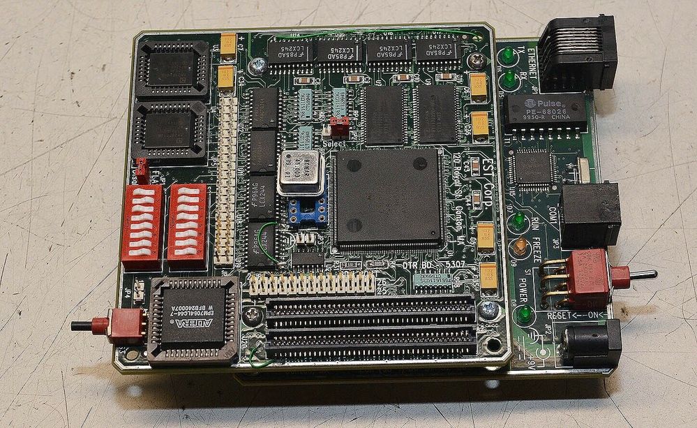

Hello there.
I was trying to get documentation and/or CD with contents (image or zipped file of that) for this particular 5307 Coldfire based board (PC104 format):
EST Wind River
Ref. MDPBAA-0649
Seems to use a base board named MDPBAA-0770 and daughter board interchangeable for several MCUs/processors, 5307 being one of them, I've seen also for MPC860 etc.
Any help or insight on how to use this board or locate its documentation and associated support files/CD will be appreciated.

TomE
Specialist II
Is that a "9950" datecode on the Ethernet Transformer? 20 years old!
The earliest dated document I have on the MCF5307 is "MCF5307ER" which lists previous revisions starting in September 1999. Sp 20 year old technology. You don't have much hope. The only way you're going to find out anything is if that board you have is in a box with all the original documentation and software. Which would probably be on floppy disks. And would need to run on a Windows 95 machine.
Wind River acquired EST Corp in early 2000:
TMF: Aquisition-Embedded Support Tools / Wind River Systems, Inc.
Here's something that looks pretty close to your board:
Wind River - Early Development Solutions for Hardware/Software Integration
Here's an earlier page mentioning the 5307 support, and the product page for that board:
ColdFire Platform Tools from EST Corp.
SBC5307
The "Specification" and PDF links don't work. That's a dead end.

mosagepa
First of all thanks to all people reading this and helping me...
Now, I don't reallty want to give up on using this "unknown" board with all the platforms either old or modern I can apply to it.
My essential doubts and difficulties at a practical level to do so are basically the following:
-TomE pointed out to the "9950 datecode on the Ethernet Transformer".
But specs say Ethernet is not implemented. How come?
-Anyway, I don't know how to implement serial interface over the supplied RJ11 connector. What's the probable pinout? I'm only used to "usual" DB9 serial ports.
-Best to use "CodeWarrior 6.2 for ColdFire Architectures" or some other more recent CW version?
-Lack of BSP and EST Wind River support. This is a real PITA to get, I have contacted Wind River support a lot by email and up to now they just provided me with a single PDF succintly describing the product and it's e.g. DIP switch configuration. Not all the info I think I'd need to properly implement something on it...
-When trying to make it work with a P&E MultiLink USB BDM, I tried to "decipher" the .CFP file that this platform uses to implement the Flash algorithm needed (this Wind River SBC5307 has 1MB Flash in 16-bit words confguration). It is mentioned a "source code" that one can adapt in order to properly implement the Flash stuff in order to dump something on it. Since people here mentioned the P&E route as being the most promising, can you please guide me on this issue?
-How to bootload this board? Or, how to start working with it? Where to look? Would I need full schematics? I'm at a loss...
THANKS SO MUCH again, to all you people. Please I know we can make this work!  I just need some orientation... I promise to share here all the findings I myself can gather on my tryings.
Any further info/ advice/ documentation/ support will be very appreciated.

TomE
Specialist II
Two possibilities. There are two boards. The lower one allows different CPU boards to be plugged into it. Maybe One of the other Daughterboards had a CPU that had an internal Ethernet controller. There's a lot of stuff I can't see on the Motherboard that is hidden by the Daughterboard. Maybe there's an Ethernet Controller chip on the Motherboard. Have you pulled the Daughterboard off to see what's there? Have you looked at the part number on U15 which is next to the Ethernet Transformer?
Do you have a multimeter? You can use that to find which pin on the RJ is ground. There should be a MAX232 chip there somewhere. See which pins on the RJ connect to which pins on that chip. That will give you RX and TX (and maybe a few others). From the Debugger you can program up the serial port (or ports) and write characters into the transmitter, and then see which pin wiggles. Very basic reverse engineering.
In order to program the Flash, the debugger has to load a program into RAM (somewhere, this chip has 16k internal). The debugger or that program has to set up the bus controller properly. Then that program has to be the right one for the right chips connected in whatever width. Then the debugger writes blocks of data to RAM and runs that program to write it into the FLASH. Usually you tell the debugger "I'm using this development board" and it sets it all up for you. If the debugger hasn't been set up for your board - well, you're on your own, and it probably is more trouble than it's worth to allow for "custom setups" like this. Better to focus on the 99% of people who have just board a new board that P&E know about.
You can of course write a program like this from scratch yourself and manually load it into RAM and then talk to it.
Schematics would help, but aren't sufficient. Have you any idea what that Altera chip is doing?
What you should do is exactly what you've done. You've asked this forum, which is your best chance for a response of "I've had this in the cupboard for 20 years with all software and documentation and you can have it".
A 20 year old system would probably need a 20 year old debug pod with 20 year old support software (that understood that board) running on a 20 year old operating system (Windows 95)  on a 20 year old computer.
USB 2.0 dates from 2001, so the debugger probably runs from a parallel port or a serial port (very slowly).
A modern pod will talk to it, but you're going to have to do all the Flash-writing yourself. Starting with writing very low-level Flash-programming code. Or adapting someone else's source code. Nobody who is sane has written any of this for 20 years, because you get all that functionality "for free" with a debug pod that supports your board.
