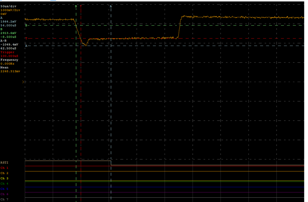

> If I brown out the 3V3 supply to 1.8V before the supervisor can pull RSTI pin low,
> when the supply goes back to 3.3V and the supervisor releases RSTI pin,
> the MCU is locked up and it can not be reset except by a power cycle.
Congratulations on finding a repeatable test.
The MCF52110 has a minimum voltage specification of 3.0V. You're using an MCP1320T-29LE part, which is specified to trip at 2.828/2.90/2.973. So that is slightly outside of specification. You should be using a 3.1V monitor at least.
You're not measuring it tripping at 1.8V. It trips at 2.9V, but is specified to have a 650us delay from the low trip point until when it drives RESET, given a slow ramp. You've giving it an astonishingly fast ramp.
The only way to remain fully within specification is to have a large enough power supply capacitor so that it takes at least 650us to fall from the 3.1V where the monitor trips until the minimum CPU spec of 3.0V. On your oscilloscope I'm seeing a fall from 3.3V to 1.8V (by 1.5V) in about 10 microseconds. To discharge 1 farad by 1 volt in 1 second takes 1 amp, so discharging a microfarad in a microsecond by a volt also takes an amp. You've got 240uF of storage, so you must have drawn 36A to drop 1.5V in 10us! Or at least 1.5A from the 10uF output capacitor. So I don't think you were just "turning it off and on again". What exactly were you doing in that test?
I suggest you see if you can get a more "realistic" test by disconnecting the input power for between "as fast as you can turn it off and on or unplug and plug" to about 5 seconds, and monitor how low the 3V3 goes. See if there are any "brownout voltage levels" where the voltage monitor DOES drive Reset that the CPU doesn't recover from.
You've found a problem, but I don't think this could be happening this way in the field. I think you've found a "power sensitivity", but in the field I suspect it may be caused by ESD or leakage back through protection diodes into the 3V3 rail. Have you checked for this case yet?
There's still a problem with the CPU where you seem to be able to "brown it out without reset" and then get it in a state where Reset won't recover it. You won't get this fixed any time soon, so you have to characterize it and then design to avoid that situation. So I'd suggest you disconnect the MCP1320 by replacing R9 with a switch. Bring it up normally, disconnect the switch, and then with a bench-top supply feeding into J1, find the minimum 3V3 voltage it won't recover from. Test this with and without the Reset signal - prove that this is a repeatable problem.

I know you do. It isn't working, is it? You KNOW that the Reset line won't reset the CPU when it is in this state. I'm saying that even with the Reset pin driven, "Browning out" the 3V3 supply line to "intermediate" voltages may be locking the insides of the CPU up.
Dropping the #V# all the way to ground fixes this condition, but dropping to 0.5V or 1V or 1.5V or some other magic level may be CAUSING this problem. So I'm suggesting you test this possibility. You can even run the unit from a bench supply and turn the voltage down and up in a controlled fashion.
> If we had powered off the board while a 5V signal was applied on SPI_CLK (directly connected to the MCU), the MCU would not come out of reset at power-on.
So it seems you've known the cause of the problem all along. When the 3V3 rail is low and the CPU is being held in Reset by the reset controller, it isn't drawing much current, so external "injection" power from a 5V signal would pull the rail high enough for it to lock up. It seems to me that the same applies to the 3V3 signals too. You should have all external "still may be powered" signals going through those buffers.
There's a very simple brutal fix for this class of problem. Put a fat resistor on the 3V3 line so it gets pulled DOWN when this happens, or when anything else tries to keep the 3V3 high. Or worse, tries to pull the 3V3 above 3.3V. And no, you can't get a 3V3 Zener to clamp the rail, these things have horrible characteristics. Zeners don't have nice sharp conduction curvesl below about 12V.

So you need a "watchdog" that turns the 3V3 rail off and on again, as that's the only way you've found to reset the CPU.
Try a resistor across the 3V3 rail. Go as low as you can without it getting too hot and without making the regulator too hot.

Yes, it works with the tests you've done, but it is not working in the failure case. It is probably "trying to work" and meeting its specifications, but when it goes wrong, the reset pin won't fix the problem.
> So, if the 3V3 supply drops from 2.9V to 2.2V in less than 650µsec, the MCU
> stops working before the supervisor can pull RSTI pin low and that would
> cause the MCU to lock.
Yes the CPU should stop working at a low voltage, but it shouldn't LOCK UP. A Reset signal should always bring it out of that. Can you test that? Disconnect the supervisor, brown it out, bring it back up and THEN give it a reset. If it resets properly this isn't your problem. Only if it doesn't reset after this have you found a problem.

olivierdionne
Hi Tom,
I found a repeatable way to lock the MCU even if the Voltage Supervisor is connected.
If I brown out the 3V3 supply to 1.8V before the supervisor can pull RSTI pin low, when the supply goes back to 3.3V and the supervisor releases RSTI pin, the MCU is locked up and it can not be reset except by a power cycle.
Here are the 3V3 supply and the RSTI on the scope. On this image we do not see the RSTI pin going back to high because the supervisor keeps it low for about 200msec.
Do you know what is the best way to fix this problem?
