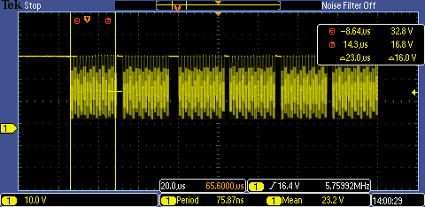

I've got code here that is using the QSPI to control three 8-channel ADCs, performing 96 conversions (interleaved data and a zero channel) at 4kHz. It has to reload the QSPI six times for each conversion. So that's "load/burst/load/burst..." and so on. Here's what that looks like:
You can see from the cursors that the 16-word burst took 23us. All six of them together (from another capture I have) took 153us. In the small gap between each of the six bursts, the CPU was interrupted, read 16 results, loaded 16 new transmit commands and started the next one. In about 3us. Meaning a 13% overhead over what a "perfect DMA transfer" could do. The SPI is running at 12.5MHz.
