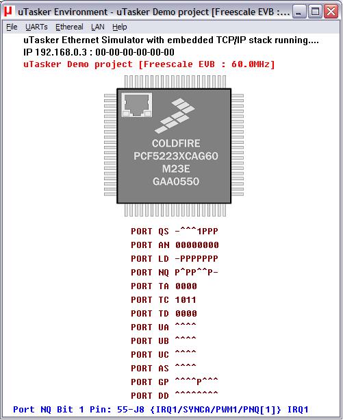

The uTasker simulator allows the user to see the function set to the port bits and to click on them to toggle their input state. If the pin state change matches the set up the simulator also executes the interrupt code so that all can be verified / tested before moving to hardware.
Below is a screen shot of the simulator in action, where the 5 IRQ pins are visible. The cursor was positioned over IRQ1 pin where its function is being displayed.
The project is open source and completely free for non-commercial (hobby, educational, etc.) use.
