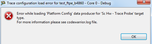

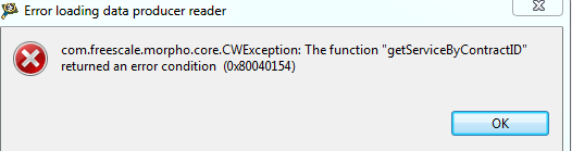

When using CW, I get errors such as
130524_130524.png2016-01-21 10_30_38-C_C++ - CodeWarrior Development Studio.png
130525_130525.png2016-01-21 10_31_46-Trace configuration load error for test_ftpe_b4860 - Core 0 - Debug.png
When I try to access the debug settings for a project. I have tried uninstalling and installing CW 10.9 again to no avail.

Hi David,
can you please remove the below plug-in from CW installation directory and  check if the behavior change!!
<installation dir>\eclipse\plugins\com.freescale.sa_2.0.0.154851-201511241343
Marc

Hi David,
These 2 errors you are seeing are actually SA (Software Analysis) component loading issues caused by SA being unable to retrieve CodeWarrior installation path or unable to write to it. Here are some possible situations:
  1. After CodeWarrior install, install path has been moved or renamed.
  2. CodeWarrior has been installed with administrator rights and it is run as normal user.
  3. CodeWarrrior install layout is somehow corrupted.
Workaround for each situation:
1.
A.
Close CodeWarrior.
Go to CodeWarrior_Install_Path\eclipse\plugins\com.freescale.morpho.core_7.0.0.10-201507202206-g855a084\xpcom\bin\components\ and delete compreg.dat and xpti.dat files.
Open CodeWarrior.
Or
B.
Close CodeWarrior.
Run register_xpcom.bat.
2. Run 1.A. or 1.B. steps as administrator.
3. Reinstall CodeWarrior. Please note that if install has been somehow corrupted, uninstall might throw errors, in this case, it would be safer to manually delete CodeWarrrior install layout.
I understand you already run steps 1.B and 3 trying to fix the problem. Could you please make sure you have run steps as indicated above? Also if nothing above helps, could you please check if compreg.dat and xpti.dat files are created or not in your layout when you are performing above steps?
Alexandra

d_li
Hi Alexandra,
I have tried all the steps above as both admin/regular user. I have also tried installing to a different directory. Results are the same. Any other suggestions? Thanks,
-David

Hi David,
Here are some questions trying to localize your problem:
1. Do you still see this specific error "com.freescale.morpho.core.CWException: The function "getServiceByContractID" returned an error condition  (0x80040154)", right?
2. While performing above steps I gave you, have you seen compreg.dat and xpti.dat files at mentioned location? If you see then please send them to me.
3. What OS are you using? I've seen is Windows from errors above but just want to make sure is one of those recommended in release notes.
4. Have you installed in the past a CodeWarrior release prior to 10.9.0, e.g., 10.8.x, that has worked without errors on machine you have this problem for 10.9.0?
5. Do you see any errors while installing CodeWarrior? Do you have low disk space warnings while installing or running CodeWarrior?
6. Have you tried installing 10.9.0 CodeWarrior on other machine also?

d_li
1) Yes. I see that specific error as shown in the image.
2) I will send you the 2 files.
3) Windows 7
4) I have used codewarrior 10.7, 10.8 and 10.5 without issues in the past
5) There are no visible warnings/errors while installing codewarrior. I have sufficient space.
6) Yes, I have installed codewarrior 10.9 w/o issues on another machine.
4,964 Views

d_li
Thank you Marc. Your suggestion has worked! :smileyhappy:

Anonymous
Deactivated User
Thx David, can you please  try this:
1- put back the plug-in
2- edit cwide-env located in <CWinstallation>\eclipse\cwide-env
3- add at the end of the file the below line:
PYTHONHOME= -add %CD%../SC/morpho_sa/bin/python
4- restart the IDE,
Marc

d_li
Relevant error from .log in workspace
!ENTRY com.freescale.sa.analysispoints 4 120 2016-01-22 10:26:33.349
!MESSAGE Internal error
!STACK 0
