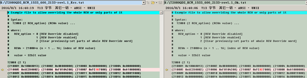

I can connect to target without hard coded rcw now with your suggestion, I found there is an RCW issue, not sure if it's a defect:
1, because on custom board, there is only nand flash, so we change rcw config to boot from nand flash.
2, with this custom rcw, the connection will failed and show:
CCSProtocolPlugin : Failed to correctly configure the JTAG chain
3, but with a rcw which config to boot from nor flash, the connection can be done successfully, the difference is here listed:
The only differenct was on the seventh rcw configuration:
210007: 0xFC187000  // failed to connection
210007: 0xFC027000  // can do connection
The bold part is 203-211 bit of RCW, and belong to IFC_MODE
Not sure here is some limitation or product defect..
