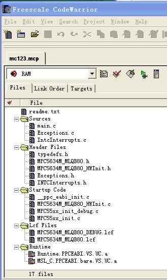

hello,I want to know the function of CW v2.8 project files which created using the wizard.can you help me? thanks.

The wizard project includes: source files (*.c,*.h) -> startup code, vector table, head files to define register address... LCF file(*.lcf) -> linker command file, to allocate memory for application libaries (*.a) -> MSL C libary and runtime library.

chaoman
but there are many others files like below picture.I want to know the functions of all 17 files.thankyouNY}$A(H@[`YLKKL4CCBQEO4.jpg
