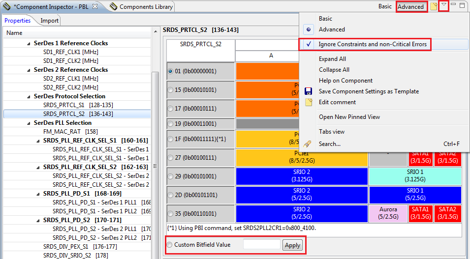

There seems to be a discrepancy between the Reference Manual (T2080) Table 19-1 for the SRDS_PRTL_S1 and S2 registers.  We Are trying to set S1 to A2 (8xSGMII) and S2 to 16 (4xPCIe,2xPCIE,SATA1,SATA2).  The Configuration tool does not allow 16 in the S2 register instead showing 15 as the option.  Also a warning message is present to check the warnings.  What is the correct setting for SRDS_PRTL_S2?
1,266 Views
addiyi
If a supported SRDS_PRTL value is not displayed in QCVS, you can use Advanced option plus Ignore Constrains and non-Critical Error and set a custom bitfield with the value of interest.
