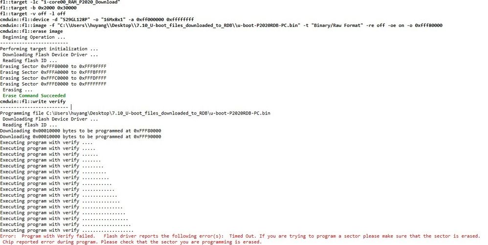

I got a problem when flash uboot.bin to our P2020RDB-PCA board by CW10.3.3.
I've done this whole procedure sucuessfully in July, but somehow it doesn't work now.
Here is console message, seems something wrong with verify step, is there anyone have similar problem?
Is the address we set are wrong or there are other mistakes?
Please help us, Thanks

We finnally found the problem that is our device selection setting is wrong.
We chose the device S29GL128P and the organization of it is 16Mx8x1, and that's the problem.
After we change the setting of the organization to 8Mx16x1, the problem solved.

To program u-boot on P2020RDB-PCA board, I have followed the steps below:
- Enter in debug mode, using init file: P2020RDB-PC_init_core.tcl and mem file: P2020RDB-PC.mem;
- In Target Tasks, import: P2020DS_NOR_FLASH.xml
- In Add Program / Verifiy Action: check Erase sectors before program + Verify after program + Apply Address Offset (with address: 0xFFF80000)
- Switches on the board: SW2: OFF ON ON ON ON ON OFF ON and SW3: ON ON OFF OFF ON OFF ON OFF
Using setup above, I was able to program u-boot with no error.
