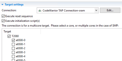

we have design a customer board based on T2081 processer, we are bring up it under hard-coded mode

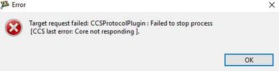

the Target Initialization file could executed normally, but the core could not be suspend and error report : core not in debug
Tools:
a) CodeWarrior TAP JTAG : USB
b) CodeWarrior Version: 10.5.1
c) Target Initialization file: T2080RDB-PCIe_init_sram.tcl ( the DDR controller should not enable on hard-coded mode which is note on T2080/T2081 reference manual, and some design are based on T2080RDB, so we used the T2080RDB-SRAM)

1) after executing the target initialization file, we click "suspend" button, a error shown that Fail to stop process [CCS last error: Core not responding]
a few second later, the CodeWarrior seems show the core is suspend, but we could not see some register value such as IFC, the error shown : Core not in debug
we open CCS log, the error also shown: CCS last error: core not in debug
2. Although the Target Initialization file is executed normally, actually it is not worked.
   I could see the core register via CodeWarrior, but the register value is not initialized as target initialization script
so please help me to review the issue, another question is how to take core in debug mode?
we have check the "execute reset sequence" in debug configuration tools

1. Please refer to section "4.6.4.1.1 Hard Coded RCW Options" to configure your target as hard-coded RCW in T2080RM.pdf.
2. When you create a bare board project, please select "Connect SRAM" launch configuration to avoid download the RAM version program to the target board.
