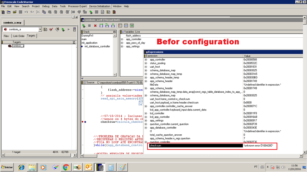

In my program, I noticed that when I use a for loop, it doesn't exit the loop unless the variable is declared static! The data in that variable seems to be inconsistent: it's impossible to check the variable's content in the debugger if that variable is not declared static, it shows *unknown error Ò100428Ó* in the expressions window and "No local variable" in the "Variables Live" section of the debugger.
Not working example: stay in the loop infinitely
int i;
for(i = 0; i < 10; i++)
    DoSomething();
Working example: loop 10 times then exit
static int i;
    DoSomething();
I use CodeWarrior for ColdFire, Version 7.0. build 15.
Maybe it's just a project setting, I don't find which one.

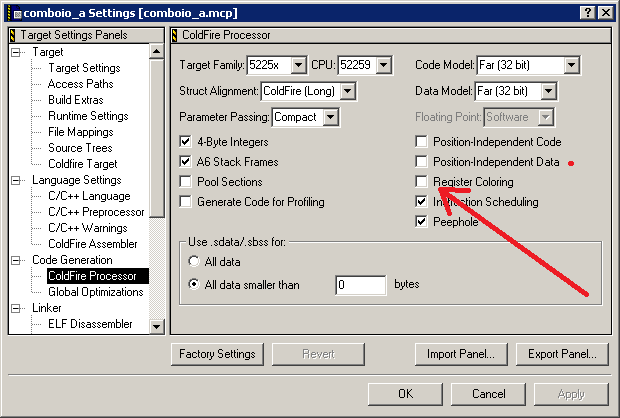

Hi people,
I had the same problem who Tom . The instruction who James answered   "Try Un-checking - Target Settings Pannel \  Coldfire Processor \Registor Coloring."
Worked for me too!

RichTestardi
Senior Contributor II
Are you running CW7.0?  I noticed this when I upgraded from CW6.4 to CW7.0.
Most local variables were not displayed in the debugger, and I got the same error message.
The fix for me was to disable Register Coloring in the project settings, under Code Generation -> ColdFire Processor.
I hope it works for you.
-- Rich

Frelon
For the local variables, you were right Rich, disabling Register Coloring allows me to see local variables, thanks!
