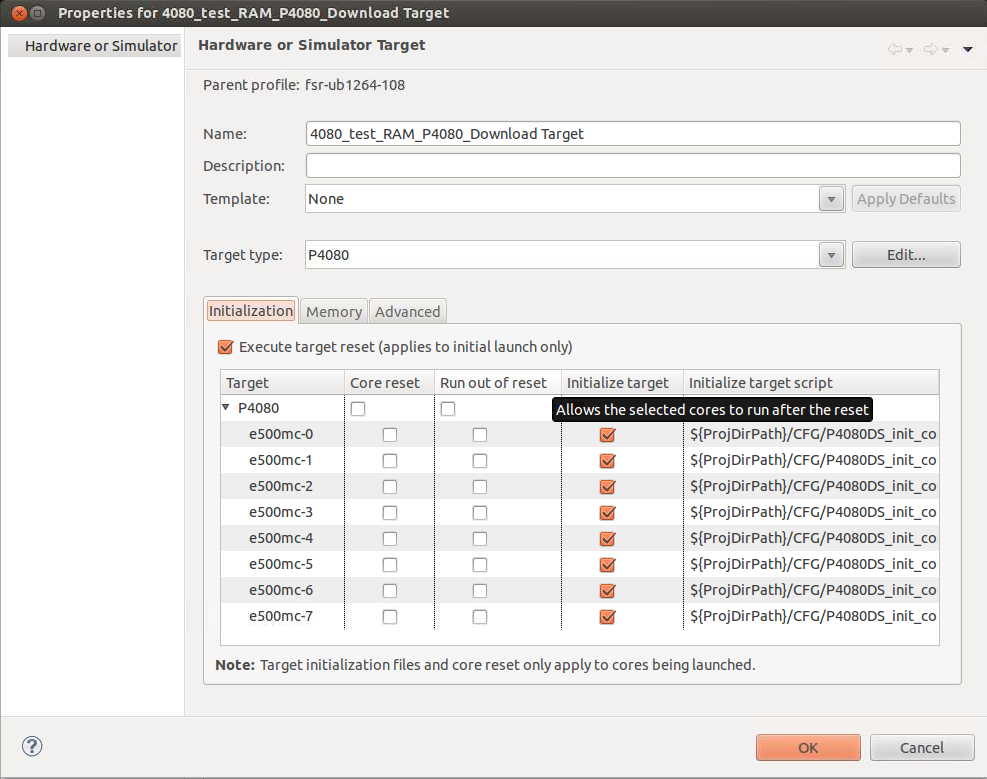

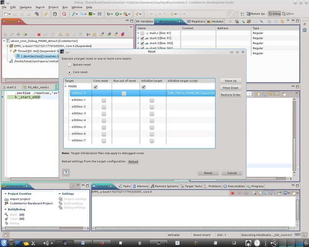

It seems to be issue of my host operating system.
I can not see some elements of CW dialogs.
Here is two screen shots:
kanat@kanat:~/work/u-boot/CW10.3$ ls *jpg
And my host operating system info:
kanat@kanat:~/work/u-boot/CW10.3$ uname -a
Linux kanat 3.2.0-37-generic-pae #58-Ubuntu SMP Thu Jan 24 15:51:02 UTC 2013 i686 i686 i386 GNU/Linux
kanat@kanat:~/work/u-boot/CW10.3$ lsb_release -d
Description:    Ubuntu 12.04.5 LTS
I have seen same behavior in Demo version of CodeWarrior 10.4.0 for PA.
What can i do to see GUI elements better?
Thanks for help in advance.

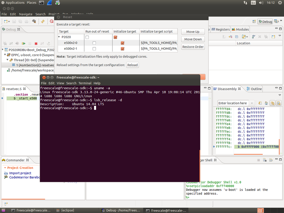

lunminliang
I am using CW10.3.3 on Ubuntu 14.04 and do not have problem. Have you installed those dependancy as in install_deps.sh?
See mine:
freescale@freescale-sdk:~$ uname -a
Linux freescale-sdk 3.13.0-24-generic #46-Ubuntu SMP Thu Apr 10 19:08:14 UTC 2014 i686 i686 i686 GNU/Linux
freescale@freescale-sdk:~$ lsb_release -d
Description:    Ubuntu 14.04 LTS

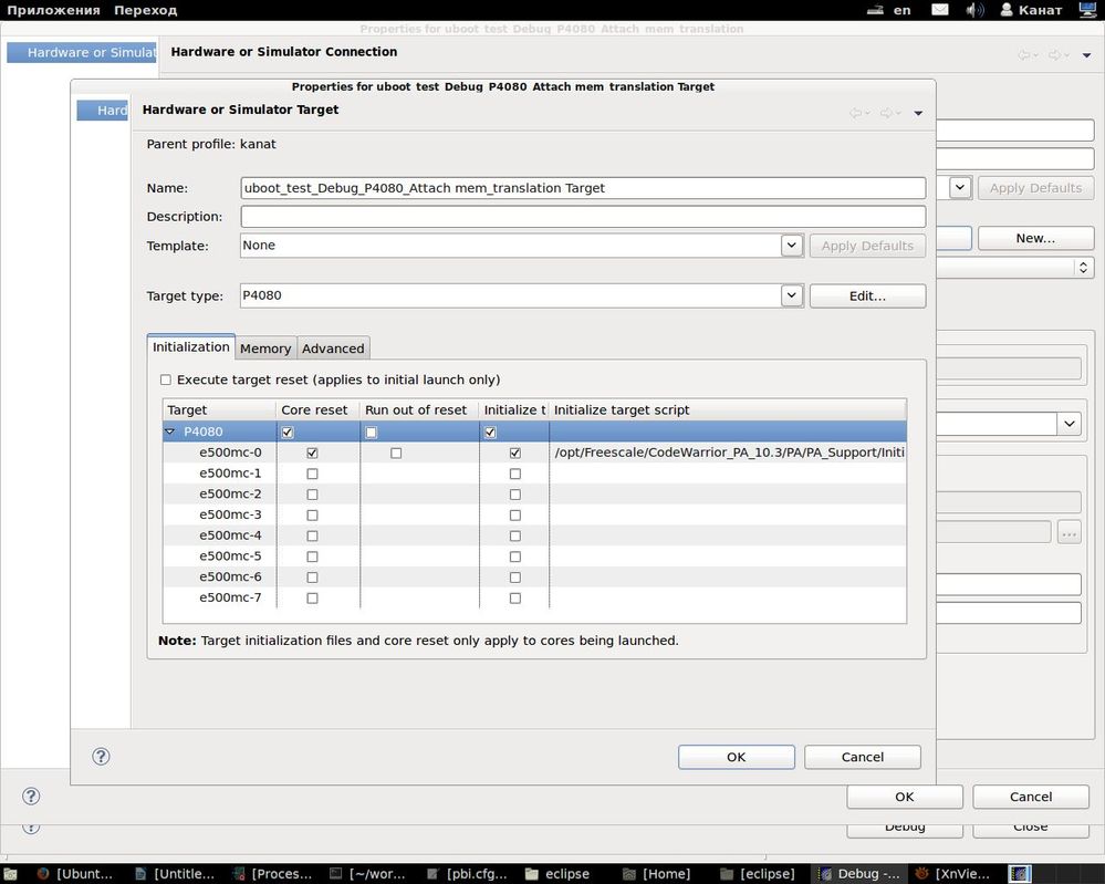

I found a workaround for this little inconvenience:
*) when Target_properties_Dialog or Reset_Dialog appears one may scroll-unscroll cores list (where e500mc-0 ... e500mc-7 listed)
   after this elements of GUI seen much better. Here is a picture.
1,155 Views

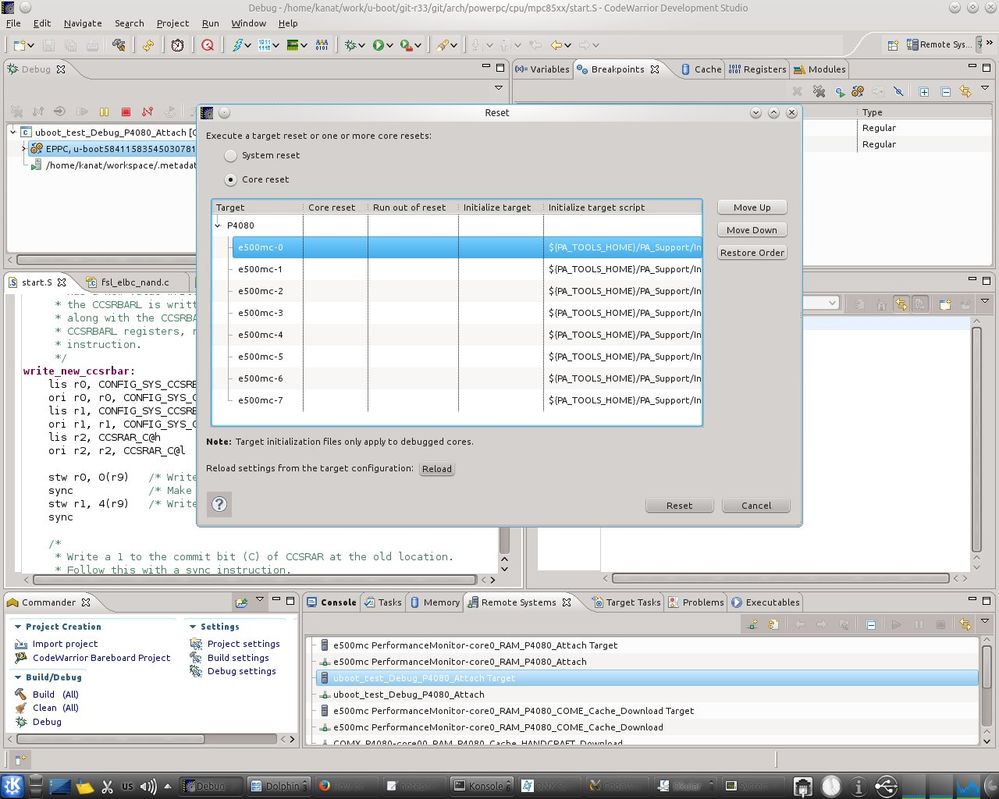

kanatalimzhanov
I have a try on my Ubuntu
kanat@kanat:~/P4080DS/Uboot$ uname -a
kanat@kanat:~/P4080DS/Uboot$ lsb_release -d
Next steps:
Settings --> System_settings --> Application_appearance --> Style --> Widget_style -->  change from "Oxygen" to "clearlooks".
A lot of changes in appearance of windows but no help to resolve my problem.
README file of CW 10.3  say that CW works on Ubuntu with default settings.
Maybe i should use default desktop system of ubuntu GNOME instead of KDE?
(now i use KDE desktop).
I will try to install GNOME desktop and write here about results.
