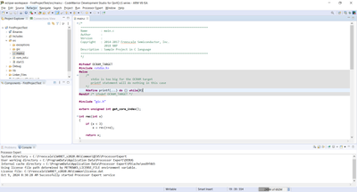

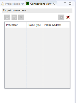

I am unable to see any target connections following the Getting Started Guide. I've been able to install CW and build Hello World bare, but attempting to deploy via Connections View comes up with empty list.
The first day I installed this software the list was available and looked like the list in the getting started guide. I wanted to note CCS binary is also not starting automatically and I believe it may be related.

btibrad
I'm afraid the extra context I gave confused the issue. I am running on a LS1043ARDB, not a custom board.

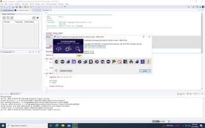

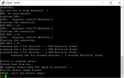

As my previous screenshots show my Connections View has nothing in it and shows Disconnected. The CCS server is not running. My target is booting just fine as I can show in this screenshot
I feel like this is a more basic issue with how I installed the software or how CodeWarrior is launching. I did try launching via fsl_eclipse.bat.

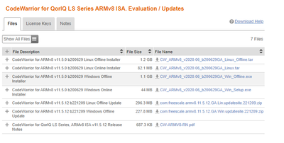

Please download CW_ARMv8_v2020.06_b200629GA_Win_Offline.exe and com.freescale.armv8.11.5.12.GA.Win.updatesite.221209.zip from the following link.
https://support.nxp.com/s/case/500KA000002GiinYAC/community-ls1043ardb-missing-target-connections-in...
Please install CW_ARMv8_v2020.06_b200629GA_Win_Offline.exe first, then open CodeWarrior IDE and install service pack com.freescale.armv8.11.5.12.GA.Win.updatesite.221209.zip from Help->Install New Software->Add->Archive.
After installing CodeWarrior for ARMV8 11.5.12, please put your "license.dat" file in folder C:\Freescale\CW4NET_v2020.06\Common.
Then refer to the section “3.2 Working with bareboard application” in C:\Freescale\CW4NET_v2020.06\CW_ARMv8\ARMv8\Help\Getting_Started_for_CW_ARMv8.pdf
7,487 次查看
btibrad
I'm afraid the download link you provided doesn't work
I installed the service pack available here, is this the same?

btibrad
Yes, the service pack is installed, no Target Connections.
I have launched using my standard account, and also as administrator. In desperation, I logged in as administrator (my IT department doesn't allow this). When logged in as an admin, I see the target connections again. This also worked on my standard account the first time the program was launched after install.
I'm at a loss, I will not be able to login as admin to use CodeWarrior.

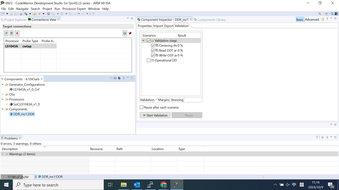

Please refer to the attached screenshot, please click the "C/C++" icon marked in red at the top right of the panel.
7,580 次查看
yipingwang
Are you using a QCVS DDR project? If yes, please double click "DDR_mc1:DDR", LS1043A processor with CodeWarrior TAP probe will be listed. Please refer to the following.
In addition, CMSIS-DAP connection is not supported in QCVS DDRv project.
