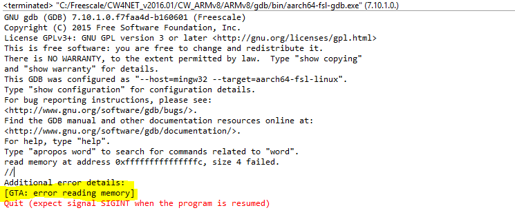

I'm try to connect to our LS1012 custom board reference design from LS1012AFDM.
First , I tested Connection Diagnostics with JTAG speed 16000 by default it's not working and error at IR Scan step.
Then , I reduce JTAG clock speed to 800. At 800kHz I can pass all Connection Diagnostics step.
Do you have any suggestion why it worked at JTAG low speed.
Regards.
Nattapong

nattapongsungch
Thank you for your answer. I will check my JTAG hardware design.
I'm not sure that is related with JTAG speed. I can do only Read QSPI such as DUMP but cannot Erase or Program.
During Erase or Program form CW Flash Programmer will not stop even Erase only 1 Byte.
Nattapong

nattapongsungch
Hi Adrian,
I get debug error.
Nattapong

nattapongsungch
Hi Yiping,
Thank you for your answer It's very helpful.
I did program RCW and U-boot successfully but cannot program PPA and Kernel (ITB 22MB).
Command that we are used. Image was download from ASK site.
fl_write 0x0 rcw_800_default_swap.bin  --erase
fl_write 0x100000 u-boot-2016.01-v201601.00.5-ls1012a-rdb-qspi_swap.bin --erase
fl_write 0x500000 ppa_swap-ls1012a_1.0.rc0-ls1012a-rdb.itb --erase
fl_write 0xA00000 itb-openwrt-ls1012a_1.0.rc0-ls1012a-lsrdb --erase
Nattapong

yipingwang
Hello Nattapong,
Please try to do flash programming under u-boot.
Yiping
5,162 Views
nattapongsungch
Thank you Yiping ,
I can programming all Images via CW.
Your answer very helpful.
