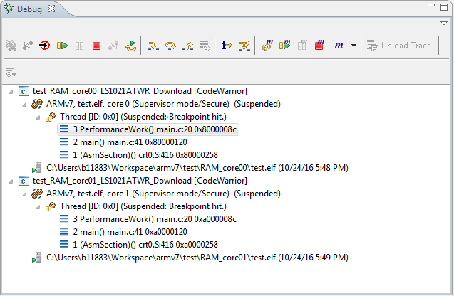

janmejayjoshi
Is there any other way?
I mean if I'm putting a break-point on a program which is suppose run on both of ARM core independently, and I want to hold program only on Core-1, Can you please suggest me something on how to put a break-point here?
Can you provide guidance to me on this?
3,131 次查看
addiyi
You can use two launch configuration (one for each core) to load the code build for core0 and core1. This way, you can stop the core1 while core0 is running, but I guess this is not your scope.
Adrian
3,131 次查看
janmejayjoshi
Let me give it a  try, if I can.
Will give feedback after experimenting on this.
3,131 次查看
addiyi
You can start by selecting both cores from wizard. AMP (One project per core) will create 2 projects, one for each core. AMP (One build configuration per core) will create one project with two launch configuration. After that you can enter in debug using both cores.
Adrian
3,131 次查看
janmejayjoshi
I'm able to have two configuration set in one project and I'm able to toggle between two configurations using GUI by just clicking Core-0 and Core-1, but not able to figure out command behind it so that I can do the same using Debugger Shell using TCL scripting.
I figured out one configuration which holds current selected core, or say currently running one, "com.freescale.cdt.debug.cw.CW_SHADOWED_PREF.Embedded Initialization.coreIndex"
But how to set this run-time, that is a question for me. Can you please throw some light on this?
How to select configuration using debugging shell?
