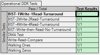

We are seeing intermittent failures on our pilot run of boards when running the Operational DDR tests in QCVS tool.  Our initial run of prototype boards ran through the same suite of tests but did not have this failures.  I believe the issue is related to a hardware failure, but I’m having difficulty interpreting the results, and I’m hoping you can shed some light on the output.  The tests we are running are as shown below:
The failure can show up in any of the chosen tests but most typically occurs in the DMA Test or the Write-Read-Compare test.  The failure that occurs is a failure to initialize, test not run.  Here is what the error log is for a failure of the walking zeros test, but the log is basically the same regardless of which test actually failed.

Any help deciphering the 0xF04: 0x00001002 output would be appreciated.
