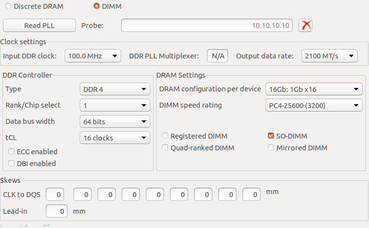

We are working with an LX2160ARDB reference board and attempting to use a 32GB DDR4 RAM module on the DDR1 controller. However, in CodeWarrior's DDR Memory Controller Configuration, we couldn't find an option for a 32GB device under DRAM Configuration per Device.
Could you please provide guidance on:
  1. How to configure the DDR Memory Controller for 32GB RAM on the LX2160ARDB?
  2. Steps to validate the 32GB DDR RAM on this platform.
  3. Instructions for updating the firmware (if necessary) to support 32GB DDR RAM.image (3).png

  1. In DDR configuration panel, please select "Read SPD" and "DIMM" as Configuration mode, then click "Read SPD" to read parameters from SPD and finish the DDR project creating.
  2. After creating QCVS DDR project, please check all "Validation stage" and "Operational DDR tests" to to connect to the target board to finish all the validation.
Please refer to QCVS DDR Tool user manual
https://www.nxp.com.cn/docs/en/user-guide/QCVS_DDR_User_Guide.pdf
  1. No need specific firmware when doing validation with QCVS DDRv tool.
