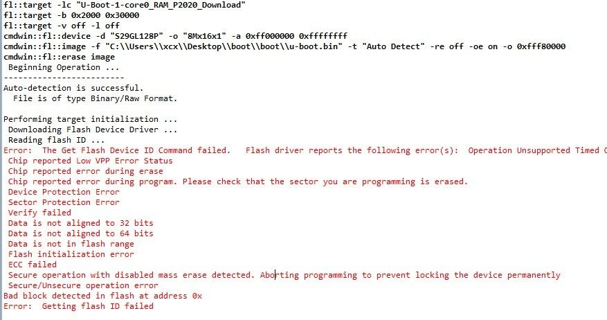

We got a P2020RDB-PCA board, but we accidentally got uboot erased.
So we tried to flash uboot.bin to NOR flash via codewarrior.
Our version is CodeWarrior for Power Architecture 10.3
We follow the leads in Cheatsheet in CodeWarrior and use USB TAP connect to the CPU JTAG on p2020rdb-pca,
but we got the console window as below:
it seems no data had been flash into NOR Flash.
Where did us do wrong? How exactly can we flash the uboot to the board?
Thanks in advance.

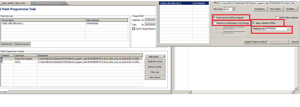

Please take a look in the attached picture for flash programming from NOR at P2020RDB. I outlined the most important settings. You must select the Program/Verify operation and set up all settings like in my picture.
Marius

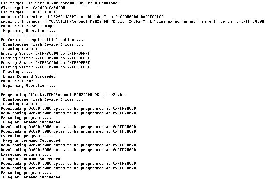

I got a P2020RDB-PCA board, but I accidentally got uboot erased.
So I tried to flash uboot.bin to NOR flash via codewarrior.
Our version is CodeWarrior for Power Architecture 10.3.3
I have used the address as specified in the FPT:
Start Address : 0XFF000000
End Address :  0XFFFFFFFF
i got the console window as below:
i reset the p2020rdb-pca board  , The u-boot can't boot up.

Hi Yin,
Looking on your console log, the offset address is correct and seems that u-boot was programmed correctly in NOR. Using Memory Viewer you can check that u-boot was correctly programmed in NOR or using Flash Programmer you can run a Dump flash action. If, u-boot is there, please check your board settings or try to use attached u-boot.

We set up as the picture you attach, but we get lots of errors that we didn't have before, attach as below.
It seems the address you set is wrong and can't reach the NOR.
Thanks as well.
Hu
6,429件の閲覧回数
marius_grigoras
What CW version you're using? What is exactly the board name and revision?
Secondly, you used a flash programmer target task or you made a new one manually?
Why in the first picture you mapped the NOR flash at addresses starting with 0xExxxxxxx ? From our PA flash programmer support, for all P2020 flashes we mapped the NOR flash at 0xFxxxxxxx addresses - is mandatory to use our flash programmer target tasks because these are in sync with the tcl initialization file.

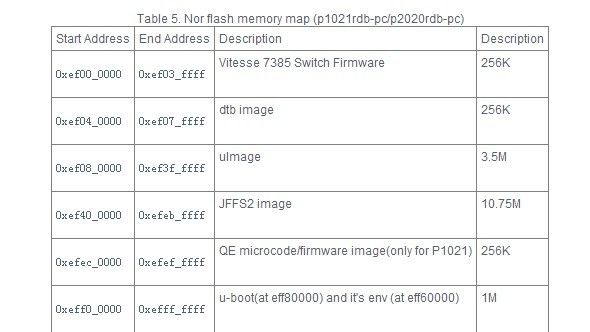

We set NOR flash address start with 0xef000000 because we found the pic below in freescale files Software and Tools Information Center > QorIQ SDK Documentation > Configuration > Hardware Configurations log
and there are same addresses setting in P1020_P2020RDB_BSP_User_Manuel.pdf.
It get me confused by what you said.  We use 0xefxxxxxx have no error just 0 bytes programmed but 0xfxxxxxx get errors in last reply.  So help~~~~

Hi again,
Please don't change anything about FP target task and tcl initialization file. Also you must use a P2020RDB-PC project and not a P10xx-P20xxRDB project.
Secondly, about the flash start address from manual or BSP user Manual, these are just some use cases/examples about possible memory map configurations. Our CW support is not aligned with BSP user manual.
