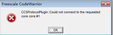

My OS is Windows 7(64bit), Development Enviorment is CodeWarrior(PA8.8.5), and the emulator is Codewarrior TAP.
After I connect the PC and my target(HPCN8641D) via the USB-TAP, the indicator leds is lighting the right information as the official guide.

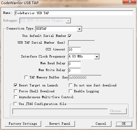

I set the debugger as the Readme file in the example projects of the CodeWarrior, however, when I want to debug the project, it just report the error:
and
Will you please help to find the methods to solve this problem!

Hello Kun Cheng,
For CodeWarrior TAP, you'll also need the 8.8.6  patch:
CW PA v8.8.6 Windows - Patch.exe
Please install it and try again.
