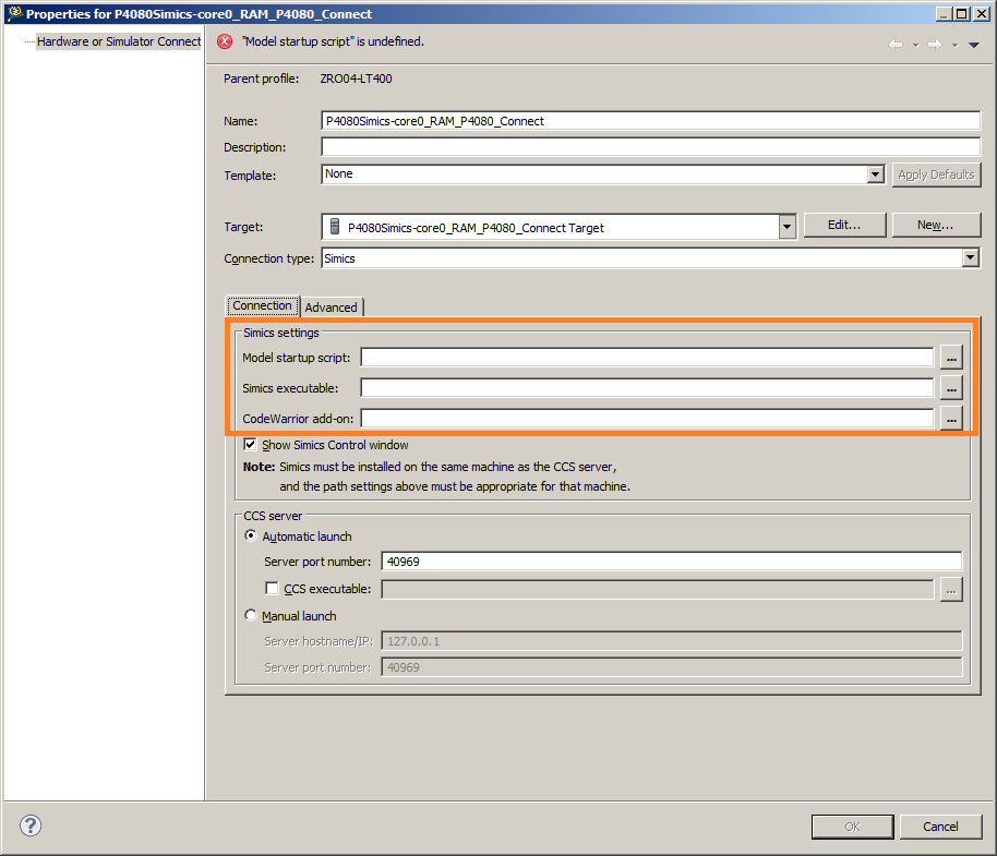

I am trying to create a sample project to run on QorIQ_P4 (P4080) as follows.
Create a Power Architecture Project --> Bareboard application--> selected QorIQ_P4 (P4080)--> build settings C language, Build tools arch: 32 bit and Floating point: None--> Debugging connection type as Simulator and core index for this project as Core 0 -->Simulators : checked the options: New system and Simics--> Finish.
The project was able to build without any errors.
But getting errors while Debugging due to lack of Simic settings (Debug as-->Debug configurations-->Codewarrier download-->Edit remote system connection--> Connection-->Simic settings). Getting errors: Simic settings undefined.
How can I get Simic settings for my project?
Thanks in advance.

To answer your questions:
>>Will these tools provide simulation environment for multi-core processors?
No, not out of the box. You need to obtain the Simics simulator from Wind River Systems to run simulations. With the Simics simulator, you can then run simulated multicore programs with the CodeWarrior debugger.

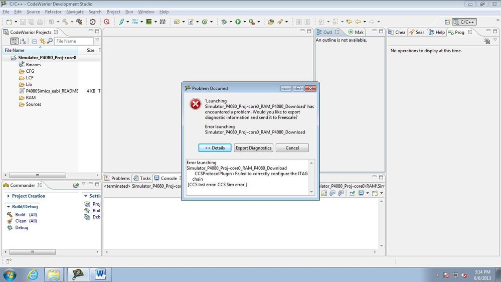

Hi Tom,
I am using Code Warrior Version 10.3.
I am trying to create a simulator project for P4080.
I am able to create the project with the default code and build it.
But when I tried to Run the code to see the printf statement, then an issue is coming. P4080_Simulator_Issue.JPG
The issue is shown as Image above.
Please check that and help me out to resolve the issue.
Thanks in advance......

marius_grigoras
You need to download and install Simics. After that, please take a look in the stationary P4080Simics file. You'll need to set up some paths in Connection settings:
Marius

marius_grigoras
Please refer to https://www.simics.net/ for the latest version of simics and the installations instructions. Note that CodeWarrior supports the Simics, but doesn't provide it.
Also you can take a look in PA\Help\PDF\Targeting_PA_Processors.pdf for any Simics inputs (how to make a project, how to make debug and so on).
