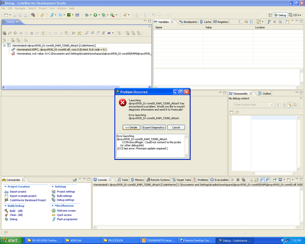

I am trying to connect Code Warrior to our T2080 processor board. It shows "Firmware update required", during attach in the debug mode connection.
Whether this is code warrior PC driver problem or target T2080 processor connection problem?

To update CodeWarrior TAP firmware in CCS, for example:
(bin) 1 % findcc cwtaps
FSL031A32 (00:04:9f:03:1a:32): Embedded CodeWarrior TAP (0)
  Power Architecture JTAG/COP Probe Tip
  Boot Loader v0.9.2
  Operating System v1.0.1
Then use the update command:
% updatecwtap FSL031A32

Hi, Karunakaran Radhakrishnan
This may indicating TAP firmware update required. Can you provide more information?
What's the CodeWarrior version used? What type of TAP used to connect the board? The snapshot of the error? Your test step?

karunakaranradh
Code Warrior 10.4.0 SP1
Code Warrior Tap (over USB)
Your test step?
connect the code warrior Tap from PC usb and other end connect to the COP connector of the our Target T2080 processor board.
1) Create a CodeWarrior Bareboard Project in the code warrior 10.4.0 SP1
2) Select the T2080 processor Type
3) In Debug setting
        *) Select download, attach and connect check box.
         *) Connection type as "Codewarrior Tap (Over USB)"
4)Remaining setting are all same and create the project.
5) In debug configuration, select our board RCW.txt file and start debug.
After 78%  it shows the "Firmware Update required" Error.
