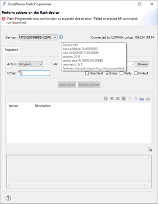

kavinR
I managed to reach the CodeWarrior Flash Programmer (after modifying the "useSafeRCW = True", RAM and IFC sections in the target initialization file of LS1046ARDB).
We have only 128MB QSPI NOR flash and 64GB eMMC on our board.
What file should I flash in QSPI NOR (it seems like we can only flash a .bin file) and where can I get it from (I mean which location in LSDK)?
When and where can I flash "firmware_ls1046axxx_qspiboot.img (it seems like we can't flash .imj file using Flash Programmer)?
After flashing, how can I check if I flashed the .bin and .img files with the right configuration?
What is the next step in bringing up the board?
Is there any console where I can see what is going on?
