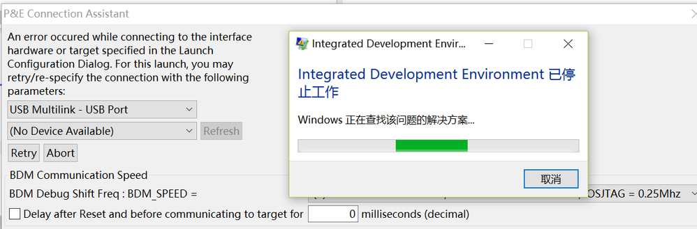

recently I got a new computer and setup the codewarrior  V10.7  .
I met a problem when I debugged the project.  My pe micro usb multilink  can't  connect to codewarrior.
then I  press the 'refresh ' button ,error dialog box come out .
how can I fix it ?
ps.  My pe micro usb multilink  can work well with another computer .
1,561 Views
xiangxu860
I have fixed this problem.
The default driver of PE-micro may have some errors. I delete it from Device Manager as shown below.
Then I connect the PE-micro  to my computer  ,and it works well .
