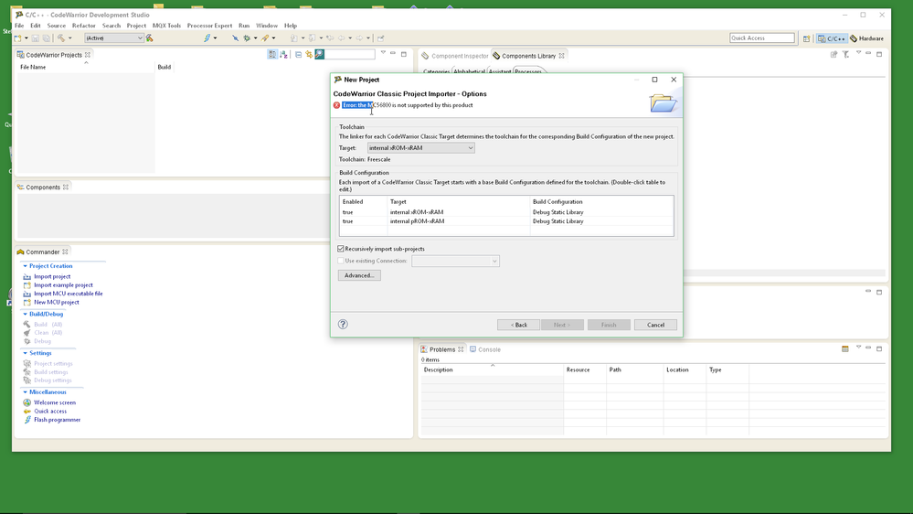

I have an old legacy project for a DSP56F801 processor. The project was developed under Vista using a classic IDE on a 32bit machine.
I am now using W10 on a 64bit hw. I am getting troubles to find out the proper IDE to use.
Any clue ?
Thank you.

Hi Tosi,
all the classic version for DSC don't support 64bit win10.
here is document of how to install CW8.3 on 64bit win7 but I never test if the same method also work for win10. You could test it if you want.
http://cache.nxp.com/assets/documents/data/en/application-notes/AN4338.pdf
Our officially recommendation is to use CW10.7 instead.
CodeWarrior for Microcontrollers-Eclipse IDE|NXP
Here is the document of how to import classic dsc project to eclipse cw/
http://cache.nxp.com/assets/documents/data/en/application-notes/AN4837.pdf
Hope this helps.

stefat54
Thank you for your answer. AN4338 seems useful. I will try.
About CW10.7 (build 160721): I installed in a W10 64bit environment and imported a classic CW8.3 design. The problem is that the original processor was a DSP56F801 and after import execution (at first sight successful) an error message glows telling "the MC56800 is not supported by this product": see please the screenshot below.
Any hint ?
