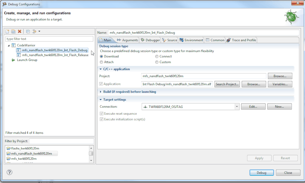

I need to make sure init_kinetis.tcl gets called every time programming a new image through debugger - since it contains code to disable hardware watchdog which requires a GPIO to be INPUT.
But I feel this TCL script is not called every time - is this true? if yes, then how to configure it to be called in CW?
David
2,922 Views
DavidS
Hi David,
Yes each time you are using the debugger it will run the init script.  To look at which init script is being used follow the below steps.  Assumption is you have a project open and compiled.
Run->Debug Configurations...
Open the "CodeWarrior" folder and select the target you want to flash and debug.  For me it is mfs_nandflash_twrk60d100m_Int_Flash_Debug.

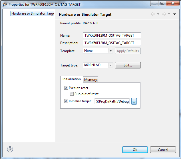

Then click the "Edit..." button under Target settings to see the below picture:

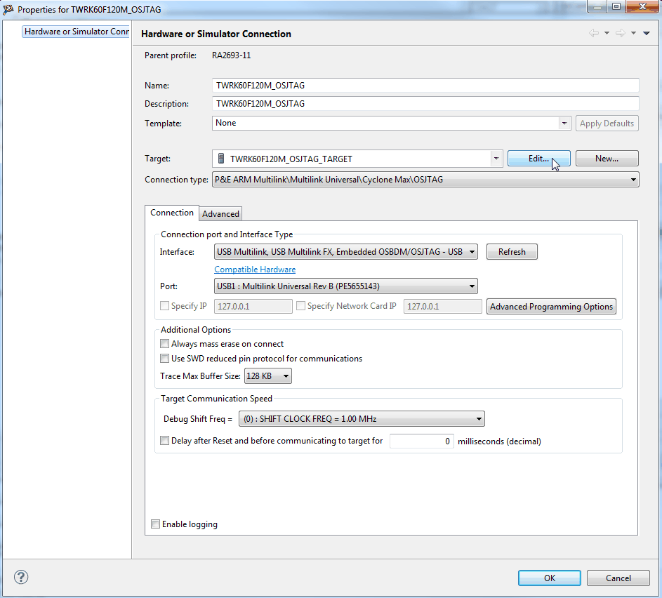

Click the "Edit..." button next to the Target to see the following window to point to the init script and tab over to the .mem file selection too:
The file name is hidden but I've copied it here for one and all to see:
${ProjDirPath}/Debugger/init_kinetis.tcl
And .mem file:
${ProjDirPath}/Debugger/MK60FN1M0.mem

David_Wu
thanks David and Sarath. I figured it out by checking "Display Selected Console" in "Console" window - and choose the Int_Flash_Debug-PnE U-MultiLink then I can see the script is executed each time.
