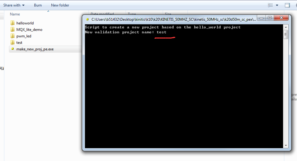

In sample code,i saw         make_new_cw_project.exe.
please explain how to create new project using that
1 返信
728件の閲覧回数
Hello Sreerama,

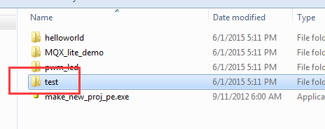

I will create a project the same as "helloworld" . This only create a simple project frame as the demo project.
The application code still need you to add .
The steps is only click it to open , then input your project name , then click the Enter button.
You can see the test project is created :
