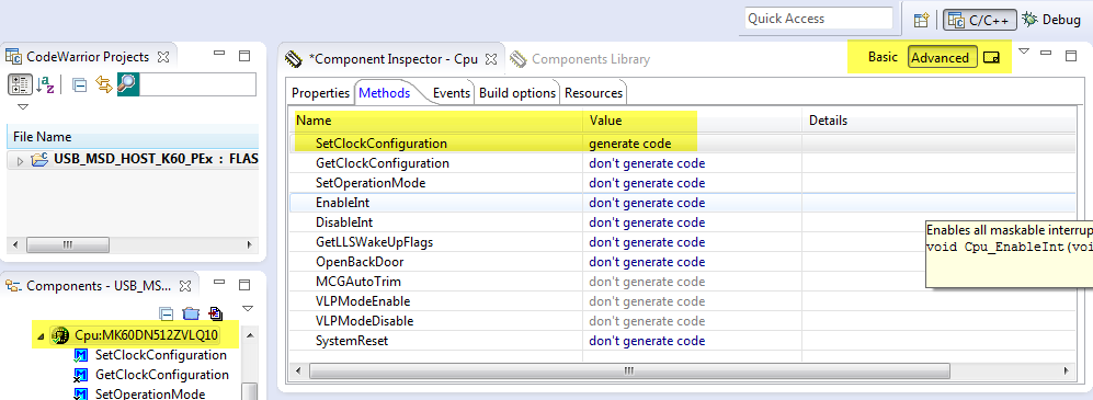

I use process expert to set 2 different system clock configuration.
But I can't find any method or function to switch between this 2 configuration?
How to? Can anyone give me a hane ?

Hi 修華 許,
Which CodeWarrior version and MCU are you using?
You could use the SetClockConfiguration method of the CPU component to switch between clock configurations.
In order to enable this method you first need to change the visibility to Advanced and on the CPU component Methods tab change the SetClockConfiguration method value to generate code:
