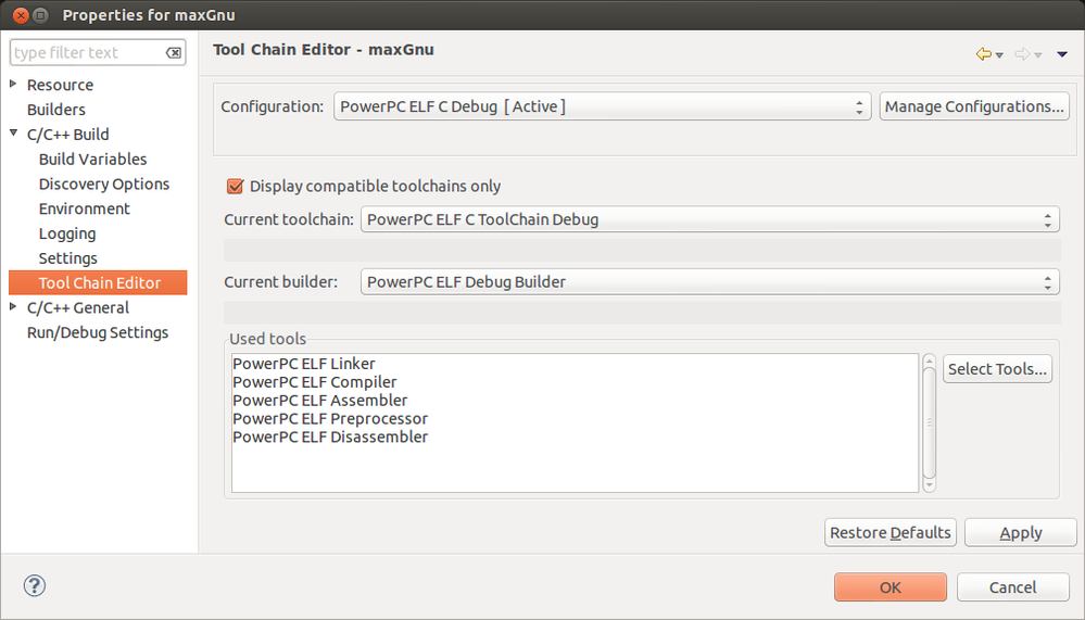

I have downloaded the evaluation version of the CodeWarrior developer studio
  CodeWarrior for Power Architecture
     Version: 10.3
     Build Id:130315
and created a project by executing New->Makefile project with existing code.
I can't find the right toolchain for my processor. It should be in the e300 family, but all I don't see it in the list of the toolchains available. I tried PowerPC ELF C ToolChain, but it doesn't seem to work.
What tool chain should I use?
Thank you.

You're suggested to use "CodeWarrior Development Studio for PowerQUICC (Classic IDE)" for your target:
CodeWarrior Development Studio for PowerQUICC (Classic IDE) Product Summary Page

Thank you for your reply. Is there an evaluation version of this tool? I can't find it. When I click Download Evaluation on its page, it only shows CodeWarrior Development Studio for Power Architecture.
Thank you.
