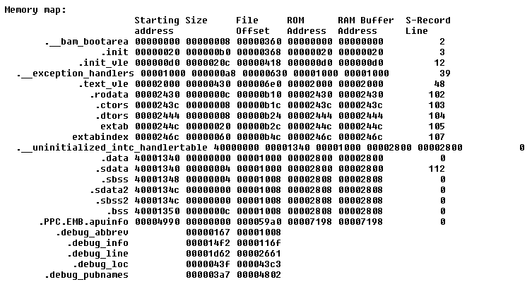

Hi!
When building my SW for MPC5602B with CW 10.6 it's not possible to view the RAM/ROM usage from the .MAP file in an easy way. I have scanned the community for solution of this problem and tried thread/358911 without success since I can not use "size" and "readelf" since I'm not running LINUX. I have also tried to use the "run readelf only" option in the P&E PowerPC Nexus development kit but without success. Are there any other ways to see the RAM/ROM usage?

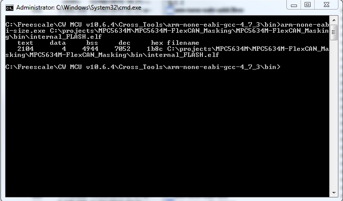

I tried to use arm-non-eabi-size.exe utility and I got correct results about ROM/RAM usage. Look at the following figure. You can check the results against  map file. I use windows7 enterprise.
Values in columns text and data determines amount of data in flash, value in column bss determines amount of data in RAM.

Hi Bengt,
It should be a part of CodeWarrior installation. Find your CW installation folder, click Cross_Tools\arm-non-eabi-gcc-4_7_3\bin and there should be many tools including this size.exe.
Just to make sure, I am sending you this example in the attachment.
