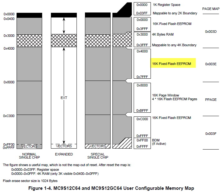

Now I'm faced with making new changes to that code, which will certainly put me over the 16K requirement.  I'm not sure if I should try using 16K Paged memory at 0x8000 to 0xBFFF in the C32 device, or try replacing the C32 device with a C64 device.
1) If I were to replace my C32 device with a C64 device, will CodeWarrior automatically use the extra memory bank at 0x4000-0x7FFF without me having to do anything with any special Page registers?  How does the compiler know which device is the target MCU? (Sorry, it's been awhile...)
2) Would it be just as easy (no involvement or special definitions by me) to stick with the C32 device and use the Paged memory at 0x8000-0xBFFF?  If this is more desirable, what do I have to do in my C-Code to let the CodeWarrior compiler use this Paged memory? (I would just want to use one extra 16K Page, not worry about Page-Switching that bank of memory).

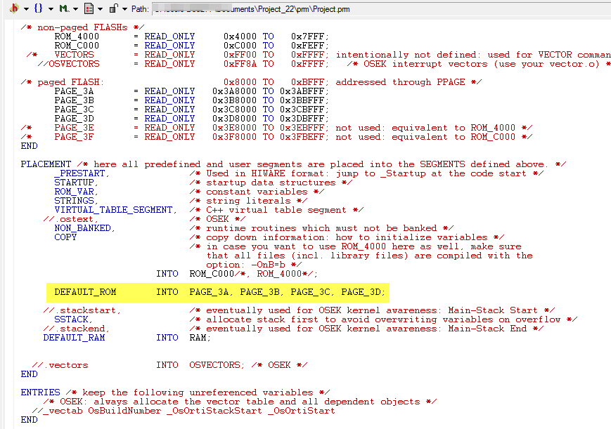

Hi BOB,
According to the datasheet 0x4000-0x7FFF is on chip 16k fixed Flash EEPROM for C64. this range of memory doesn't exist in C32.
If you need port a C32 project to C64. Basically we need at least:
1. replace prm file with a C64 prm file (create a new C64 project with wizard can generate a correct prm file )
2. replace header file with a C64 header file.
3. when launch hiwave debugger, change chip to C64 (debugger menu "HC12MultilinkCyclonePro", "Set derivative")
If you use banked memory model, the code can access page or non-paged memory with default access.
prm file is to define the memory allocation. User can modify prm file for own requirement
for example
in this prm file, the default code is allocated in PAGE_3A, PAGE_3B,PAGE_3C, PAGE_3D in order.
Jennie Zhang
