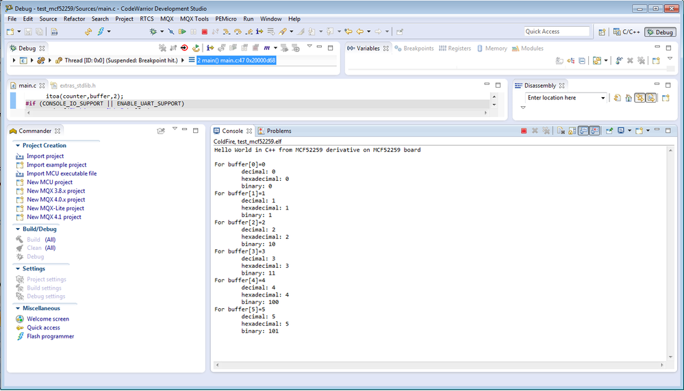

Hi Bhavya,
With MCU V10.5, I've created a short example using the itoa function.
To execute and test the project I'm using the TWR-MCF5225x (based on MCF52259).
According to the EWL C Reference.pdf manual, page 348:
27.3.2 itoa()
This function converts an int value to a null-terminated character array.
#include <extras/extras_stdlib.h>
char * itoa(int val, char *str, int radix);
In my application I added:
No other action was done.
Attached you will find the example I've used.
Pascal
