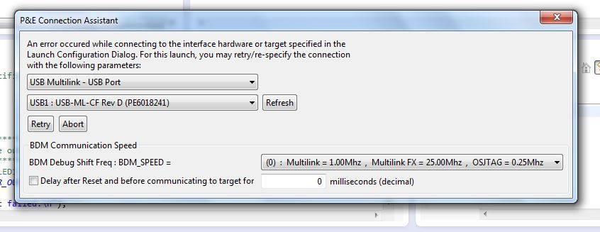

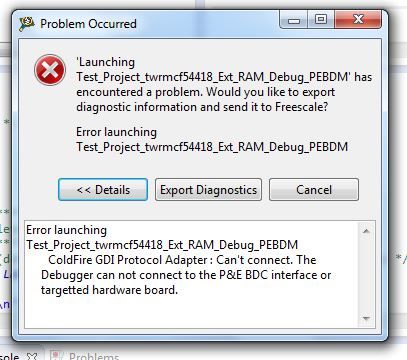

i am using Code warrior 10.5 with MCF54415, windows x64 Environment.
currently i am facing one issue, whenever i connect the PEBDM(USB Multilink Rev.D) to my Board it always shows one error :
An error occured while connecting to interface hardware or target specified.
Attached the Snapshot of Error.
Please help me out of this error.

Hi Kunal,
There are many reasons why you can get this error. Please see below the most common problems and how to solve them:
1)      First restart CW and unplug the MCU to be sure that CW is not causing the debugger lines to keep some values that are not allowing the MCU to be programmed.
2)      The MCU is not being flashed correctly
Please find attached a video showing 4 different ways to flash a Freescale Kinetis device (the process for ColdFire processors is the same).
3)      Your connection is corrupted
You can either create a new connection or create a new project which will create automatically a new connection, and then you can use the new connection to flash your original project.
4)      USB Multilink is defective or firmware is no up to date
You can download latest firmware from P&E Micro website: http://www.pemicro.com/products/product_viewDetails.cfm?product_id=163
5)      USB Multilink Drivers were not installed correctly
One solution is to do a re-install of CW, but because this is very time consuming, you might try another approach; installing the drivers manually. The good thing is: you can install the drivers from <CW installation path>\drivers\P&E.
But the WinDriver one is a little bit tricky (as Windows does not recognize it with ‘scan for new hardware’).
The needed steps are shown in the attached document (Installing PnE Jungo Drivers Manually.pdf) so you know how you can install the driver manually.
You can also find an FAQ on the web about driver re-installation: http://www.pemicro.com/faqs/faq_view.cfm?id=29&menu_id=faqs
6)      Hardware problem or hardware design problem
I recommend to double check that your hardware is not damaged, after this you can compare the TWR-5441x schematic with yours and verify that there is no problem with the debugger lines.
http://www.freescale.com/webapp/sps/site/prod_summary.jsp?code=TWR-MCF5441X
http://www.freescale.com/files/32bit/hardware_tools/schematics/SCH-26131.pdf?fr=g
7)      The Flash device you are using is not supported my CodeWarrior
If you decide to use a Flash device that is not supported by CodeWarrior you must make two things to have it usable.
A.      Create a Flash Algorithm
CodeWarrior uses .elf files which describe Flash algorithms. Although some flash memories have the same physical characteristics, the program and erase time cycles may change from one memory to other (even if they are from the same manufacturer). This is why you must create a flash algorithm for the device you have selected. In your CodeWarrior installation path you can find a document which explains how to create an algorithm for a flash device.
C:\Program Files\Freescale\CW MCU v10.5\MCU\Help\PDF\AN3859.pdf
B.      Create the flash device description and add it to CodeWarrior
Once you have the appropriate algorithm for your flash memory you must create a device description. The device description is a bunch of parameters that you must add to a .xml file with the appropriate Syntax. This file contains all supported flash devices. You can generate this information by yourself or you can use a script to generate the info and just paste it in the .xml file. Look to the same document for this purpose
Hope this helps!
