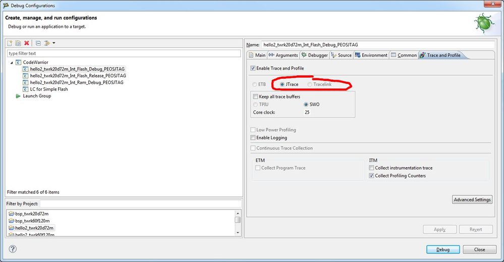

We bought a trace link (PE Micro) and I am trying to trace my Kinetis K20 software. But unfortunately I can in the debug configuration in the area of trace and profile not select the button Trace link.
Can everyone help me?

Hello Kaeven:
I think the connection is not allowing you to choose the Tracelink option. In your image I can only see connections for OSJTAG, but not for Tracelink.
The attached video shows how to create a new connection and select Tracelink as the debug tool. Please give it a try.
Hope this helps!

Hello Jorge,
thanks for your quick reply. Your assumption is correct. The micro-controller I use (MK10DX256VLL7) does not have the trace interface for ARM ETM, which is necessary for the traces with TraceLink (PE-Micro).
