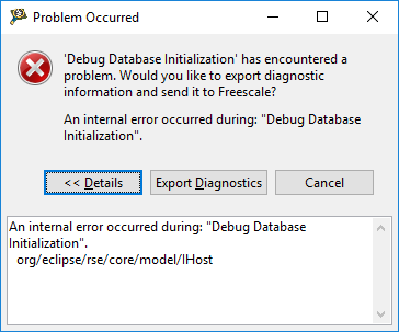

I've been using CodeWarrior 10 for several years however recently I received an error which prevents me to perform Flash Program or debugging.
The error is showing at the start of the IDE even there's no project opened.
I've tried uninstalling and installing the Microsoft Visual C++ Redistriutable packages but it seems not related to the problem.
I've attached the diagnostics for more information.

Hi Donald,
Please check if solution in this link can also work you.
https://community.nxp.com/message/368501

I followed the instruction to delete the .metadata folder and it fixed my issue.
Thanks!
