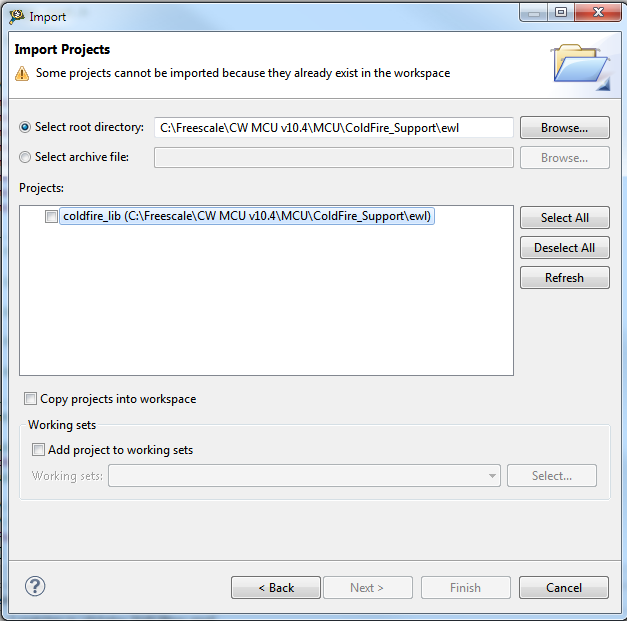

Take a look at this thread: Odd / Irrelevant Linker Warnings in CW v10.4
I was able to import the coldfire_lib located at C:\Freescale\CW MCU v10.4\MCU\ColdFire_Support\ewl
locate coldfire_lib project to import into CW 10.4

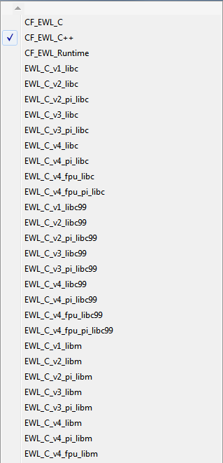

Once imported, select Build configuration and  a large menu like the one below is displayed.  Select the appropriate build configuration and do a clean and build. See sequence below
I cleaned and rebuilt these configurations in this order:
1) ALL the EWL_C_v1_xxxxx configurations
2) CF_EWL_Runtime
3) CF_EWL_C++
4) CF_EWL_C
5) Cleaned and built my project
