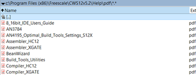

The assembler of the CodeWarrior can be found in the installation directory
