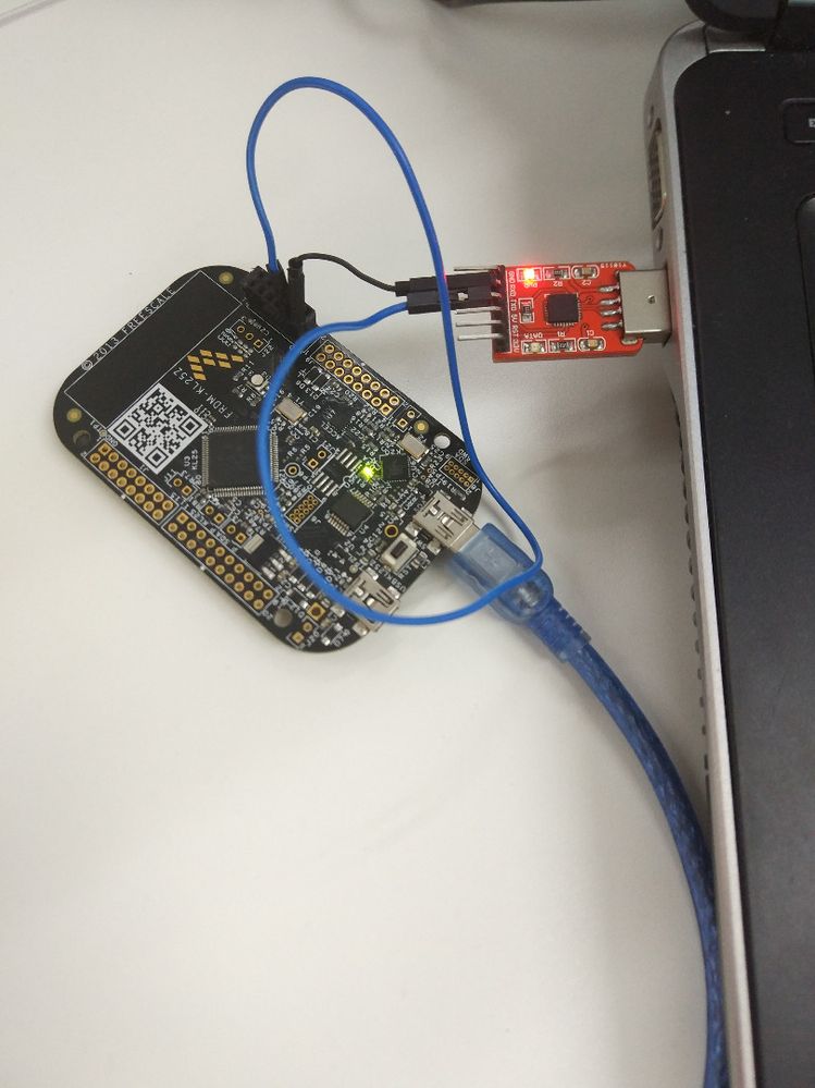

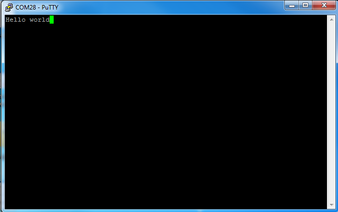

Hello Akash,
I create simple project with Processor Expert based on CW10.7 ,
refer to your requirement , it can work well :
Please be sure connect the right pin :
PTE20 is the  J10-1 on board ,
PTE21 is  J10-3
I also attached the simple project .
