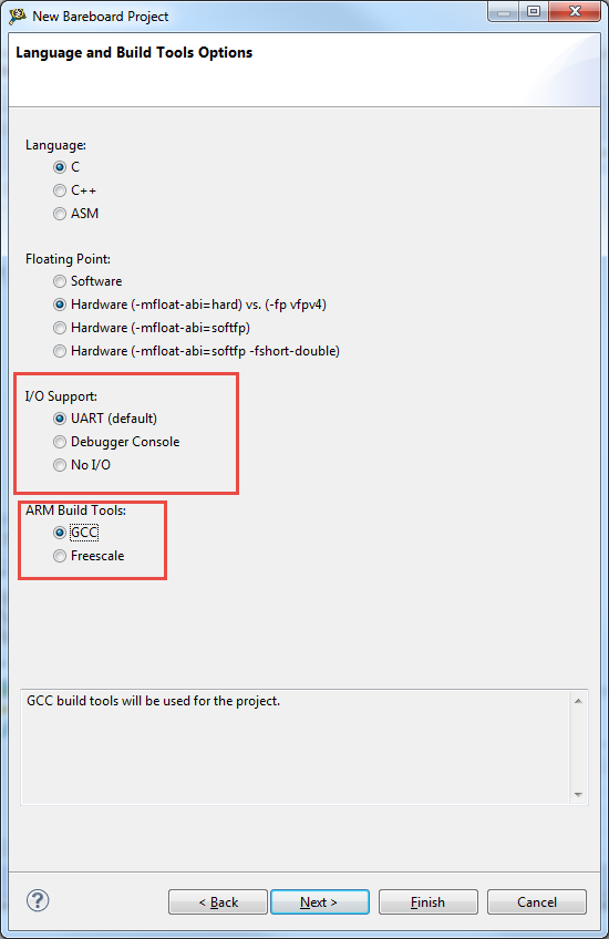

Hi Tho,
You've always used CW for MCU v10.5 ?
What does this means "I have used sprintf in the past with floats with no problems." ?
By default when you create a project with the wizard you can select 2 options:
      -> I/O support
      -> ARM Build Tools
Depending of the options selected this could have an impact of your project - libraries included.
Pascal
Freescale Technical Support
4,876 Views

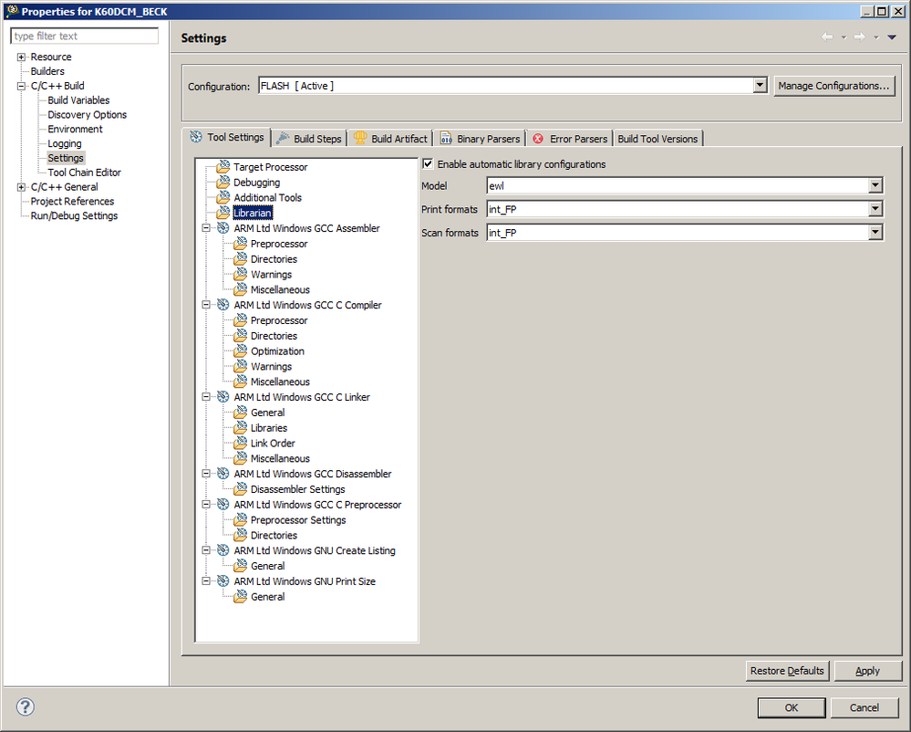

thoborawski
What I mean by "I have used sprintf in the past with floats with no problem" is that it has worked in the past on other projects
with no problems.  Now it does not seem to work correctly. I setup the project with hard float, the UART box checked as you show in your screenshot along with the GCC option.
I also have the librarian setup for model ewl and print formats "int_FP" as shown below:
