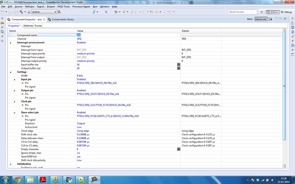

I am using the SynchroMaster processorexpert component to talk to a simple 4-wire SPI component attached to a TWR-K60F120m via the primary elevator. My settings are included at the bottom. I am using simple code to test (below): check buffers are empty, send the characters, wait for the transmit buffer to empty and the receive buffer to fill up, read out all the characters.
My problem seems to be that I always get back 0xff bytes no matter what should be coming back. I know that the SPI slave device works correctly as it has been tested on a different microcontroller. I am going to try to get my hands on a logic analyzer, but for now does anyone have any idea what might be causing this?

I have now changed my code to use SendBlock/RecvBlock instead of SendChar/RecvChar.
I was able to get a logic analyzer trace of an SPI master-write transaction (top to bottom: Clock, MISO, MOSI, Chip Select). From this I can see that the MISO signal is always high and thus the 0xff value is 'correct'. However I think this is happening because the chip-select is toggling between bytes, whereas the slave device requires the chip-select to be held low for the duration of the transaction (usually 5, 8 or 11 bytes).
If I look at the SMasterLdd1 subcomponent, I can see that 'Chip select toggling' is set to 'no'. Do you know why the chip select appears to be toggling and is there a way I can hold it low for the duration of the multi-byte transfer?

I disabled the chip select pin in the SynchroMaster, and instead controlled it myself manually using a BitIO component. This works, and I am now receiving data correctly. This confirms that the problem was that the chip select was being toggled, even through 'chip select toggling' was set to 'no' in SPIMaster_LDD. Is this a bug in processor expert or one of its components? I would prefer to use the component properly rather than using the BitIO workaround.

Hi, I am using CodeWarrior for MCU, Version: 10.6, Build Id:140329. I am using the Processor Expert that came bundled with it, version 10.6.1. My installation is up to date.
My Processor Expert file for the bsp_twrk60f120m project is here.

I realised the PE file I sent you is after I made my 'fix' (controlling PTD11 manually using BitIO). But I have checked and I am not using PTD11 for anything else.
I think it probably works on many devices, where the chip select can be toggled between each byte without any problem. But on my particular device the chip select must be held down for the entire multi-byte transaction, and the PE code doesn't seem to do this.
I haven't been able to confirm it (I am new to debugging with Codewarrior + microcontrollers in general) but it looks like the CONT bit in SPI2_PUSHR is not being set. This appears to be what tells the MCU to keep the chip select down for the duration of the transaction.
