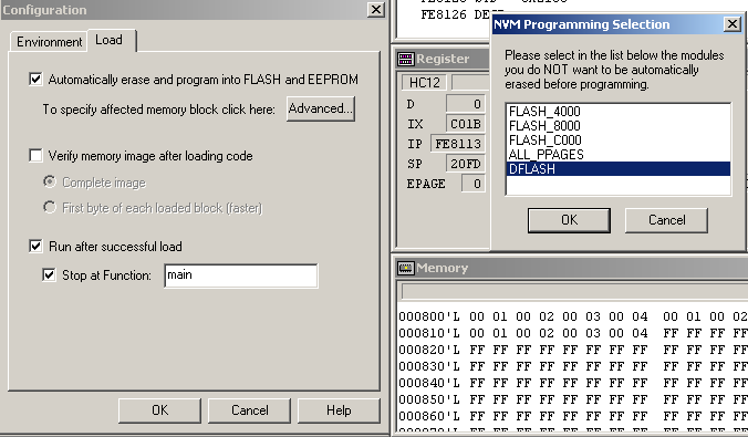

Good morning.
I have already seen this topic
usb BDM. How to program flash & leave Eeprom as is
but in my casse it doesn't work.
I want to debug my firmware with Cyclone Pro and I use Codewarrior 5.9.0. I want to preserve my EEPROM data
I deleted this entry in Mcu03CB. fpp file :  MODULEIMPORT MC9S12_EEPROM_EETS2K_W_HIDDEN          -> EEPROM is blanked and debugger doesn't work correctly = program doesn't run
I deleted Mass erase EEPROM section in erase_unsecure_hcs12 -> debugger doesn't work: it seems to program the micro but debugging is impossible and program doesn't run
In debugging Memory map, in CyclonePro Menu (Truetime simulator) I set EEPROM entry active = NO   -> there is no effect
With Cyclone PRO I load SAP Image but the algorithm for MC9S12A128B hasn't got "Protect EEPROM " command
I inserted in Startup script AEFSKIPERASING command but it doesn't work
Can you help me?
Thank you very much

RadekS
There is a way to avoid erasing EEPROM while programming the Flash module.
  In True-Time Simulator & Real-Time Debugger window of CodeWarrior, go to main menu and then File -> Configuration...
  Select Load tab, click on Advanced and select the modules you do not want to erase.
Note: Picture show different MCU, but principle is the same.
