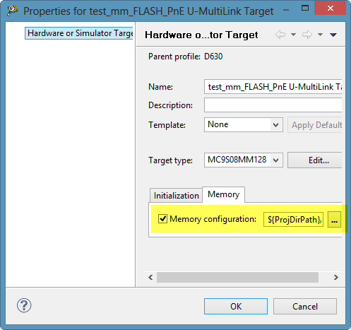

can you check if you have that memory file (explanation of different files in the project is here: Dissection of MCU10 Projects | MCU on Eclipse)? Usually inside Project_Settings\Debugger.
The memory file is referenced from the debug/launch configuration > Main Tab > Connection > Target:memory configuration.png
