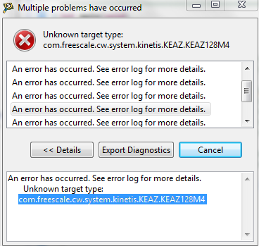

When I try to load the practice labs that came with my StarterTRAK TRK-KEA128 MCUs, I get an error for Unknown target type: com.freescale.cw.system.kinetis.KEAZ.KEAZ128M4.

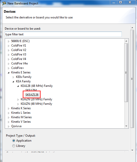

In addition, if I try to create a new MCU project, I am not given the option to select this device as my target. I have tried reinstalling and installing on another device, but it has not worked. Does anyone have any suggestions?

Hello Tyler,
Which version of CW do you used ?
I use the CW v10.6, please see the screenshot , it have the chip of KEA128.
please take a screenshot about yours .

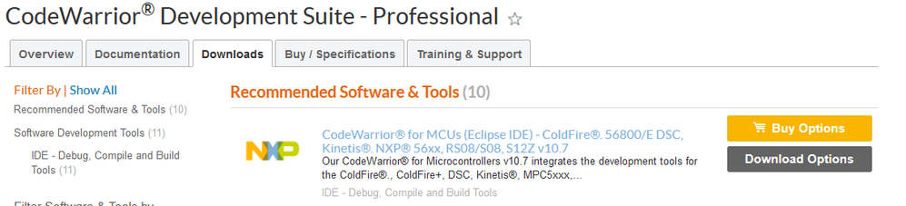

And i recommend you use the latest version of CW v10.7, you can download it at here :
CodeWarrior Dev Tools Suite - Professional|NXP
