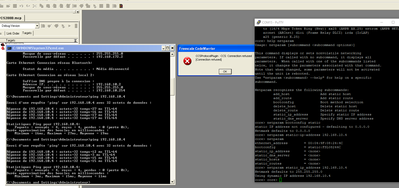

I need help please. I'm lost with this issue for days.
I work with Windows 10 64bits. I try to connect and debug a board with a MPC5200B.
I've downloaded CodeWarrior MobileGT v9.2 I use the CodeWarrior USB Tap. Driver is libusb32 (tried many others).
I've tried with windows 8 64, Windows 7 64, Windows 7 32bits and even Ubuntu 14 =Always the same result.
CCS integrated with mobileGT v9.2 is unable to connect to USB tap
Here is the log :

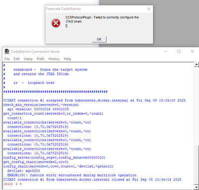

CodeWarrior MobileGT give this error :

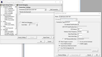

And here is the setting :

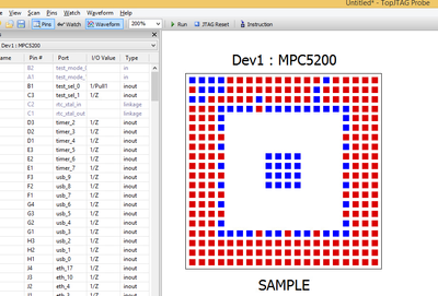

I can connect to the board I need to debug with USBBlaster and TopJTAG

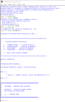

I've received the new probe!
But I need a probe tip
Do you know which one do I need to use?
3,866件の閲覧回数
telectroboy
I reply to myself!
I use a ONCE USB Tap Probe! And it seems I need the CWH-CTP-BASE-HE probe ! I didn't know. Just saw it in this forum.
Just ordered the probe and waiting for it. But if someone could confirm this info... Could be great
