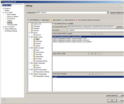

Thanks for the patience.
Our CodeWarrior expert provided a quick workaround:
 It is necessary to add the next paths to Linker Settings -> Library Search Path:
"${MCUToolsBaseDir}/ColdFire_Support/ewl/EWL_C/src"
"${MCUToolsBaseDir}/ColdFire_Support/ewl/EWL_C/include"
"${MCUToolsBaseDir}/ColdFire_Support/ewl/EWL_C/src/coldfire"
Also see picture attached.
With above workaround I could pass project build and with below warning info:
Wish it helps.

Hui_Ma
Wish it helps.
Mike
7,382 Views
breel
This worked. Thank you!

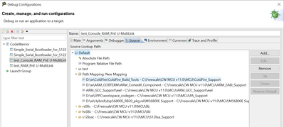

This is caused by the ewl libs delivered as pre-compiled with this path "D:\w\ColdFire\ColdFire_Build_Tools\ewl\EWL_C\src\printf.c" to the source file.
In order to change it you should rebuild the ewl libs on your machine. This will change the original absolute path to the source file to your pathsa and you can generate disassembly including lib source C statements.
The debugger can show the source code properly even without rebuild due to path mapping set. See below:
Hope it helps.
